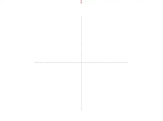

Anyway, while I was investigating asymptotic behavior of $f_n(x)$ in Mathematica, I got sidetracked and (just for fun) looked at the set of complex roots when I set $f_n(x)=0$. For $n=24$, the plot looked like this: (The real and imaginary axes are from $-1$ to $1$.)
n=24

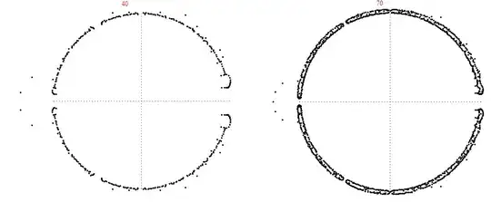

Surprised by the unusual symmetry of the solutions, I made the same plot for a few more values of $n$. Note the clearly defined "tails" (on the left when even, top and bottom when odd) and "cusps" (both sides).
40 and 70100

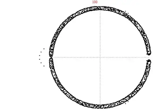

You can see that after approximately $n=60$, the "circle" of solutions starts to expand into a band of solutions with a defined outline. To fully absorb the weirdness of this, I animated the solutions from $n=2$ to $n=112$. The following is the result:
n=2 to 112
Pretty weird, right!? Anyhow, here are my questions:
  1. First, has anybody ever seen anything at all like this before?
  2. What's up with those "tails?" They seem to occur only on even $n$, and they are surely distinguishable from the rest of the solutions.
  3. Look how the "enclosed" solutions rotate as $n$ increases. Why does this happen? [Explained in edits.]
  4. Anybody have any idea what happens to the solution set as $n\rightarrow \infty$? Thanks to @WillSawin, we now know that all the roots are contained in an annulus that converges to the unit circle, which is fantastic. So, the final step in understanding the limit of the solution sets is figuring out what happens on the unit circle. We can see from the animation that there are many gaps, particularly around certain roots of unity; however, they do appear to be closing.

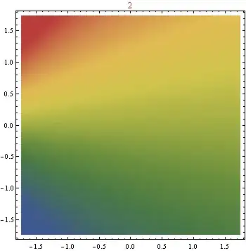

EDIT: Here is an animation $Arg(f_n)$ up to $n=30$. I think we can see from this that $f_n$ should converge to some function on the unit disk as $n\rightarrow \infty$. I'd love to include higher $n$, but this was already rather computationally exhausting.
Avoid this if you've been taking any hallucinogenic drugs.
