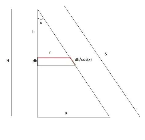

Anyway, for a derivation, look at the following figure:
alt text
This is a cross-section of the cone.
The area of the strip of width $\displaystyle dh$ that corresponds to $\displaystyle h$ (from the apex) is $\displaystyle 2\pi r \frac{dh}{\cos x}$
Now $\displaystyle r = h \tan x$
Thus $\displaystyle dA = 2 \pi h \frac{\tan x}{\cos x} dh$
Thus the total area
$$= \int_{0}^{H} 2 \pi h \frac{\tan x}{\cos x} dh = \pi H^2 \frac{\tan x}{\cos x} = \pi (H \tan x) \left(\frac{H}{\cos x}\right) = \pi R S$$
Hope that helps.
Aryabhata

  • Can you please explain how you find the area of the strip? I can't seem to understand. – Stephan May 01 '20 at 17:05
    @Stephan: The assumption is that it is same as a rectangular strip of width $dh/\cos x$ and length equal to circumference $2 \pi r$ and so area is the product. – Aryabhata May 07 '20 at 23:07
