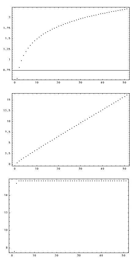

Just to give people an idea on convergence rates, here is a plot of $-\log_{10}\left|\frac{S_n-\pi}{\pi}\right|$ versus $n$ , where $S_n$ is the nth partial sum of the series in question, for three of the series featured in the answers to this question (note the vertical scale):
The three series are, from top to bottom, $\arctan(1)$ (the series mentioned by the OP), $2\arcsin\left(\sqrt{\frac12}\right)$ (the series mentioned by yjj in his answer), and the series by Ramanujan I mentioned in the comments (I didn't include the series by the Chudnovsky brothers, since that converges even faster than the Ramanujan series, and that makes for boring plots).
