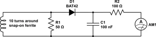

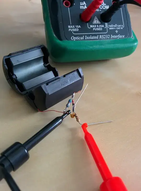

snap-on ferrite detector
You can make a detector with a diode, and a current transformer from a snap-on ferrite, such as those used to snap onto cables for EMI suppression. This will work for HF, but at higher frequencies the loss in the ferrite will become significant. Higher frequency ferrites are available, but not usually as snap-on beads.
schematic
simulate this circuit – Schematic created using CircuitLab
The component values are not at all critical. I've used a Schottky diode, but an ordinary 1N4148 will also work with reduced sensitivity.
I've made R2 small to maximize the current through the meter. If you are measuring larger currents, or have a very sensitive meter, increase R2.
I just use my digital multimeter, and left the components hanging off the ferrite. It's ugly, but effective. Keep the lead lengths short. The long meter leads are fine because the RF has been rectified to DC by that point.
This device can be roughly calibrated by measuring the current through a known load. I put two half-watt, 100 ohm resistors in parallel, soldered them onto a connector, and plugged them into my transmitter as a 50 ohm dummy load. I set the transmitter power to minimum, clamped the ferrite around the resistors, and keyed up briefly. 5 watts into 50 ohms should give about 316 milliamps, and I read about 3 milliamps on the meter.
The non-linear diode will make the relationship between actual and measured current not linear, but that's good enough for a gross calibration.

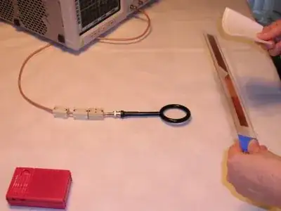

All kinds of devices can be used as detectors and probes.
An oscilloscope can work: try simply laying the probe next to the wire being measured, or making a loop probe. Put more turns in the loop for more sensitivity.
magnetic field probe orientation
A 2nd radio works also, without an antenna, or with a dummy load to reduce sensitivity.
