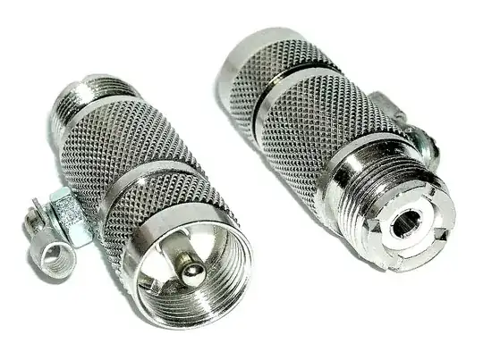

You could also use a lightning arrestor type device and connect the ground tab to the fence:
Make sure to waterproof this connection. At the same time, I would eliminate the connection to your gas pipe ground wire.
