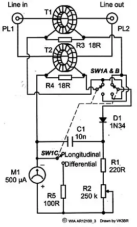

If you are using balanced transmission line and you wish to measure the balanced and common mode currents, you can construct a simple instrument such as this:
The details of this instrument are discussed by the author on his website. Do exercise caution as this author has previously published articles that are, in my opinion, grossly wrong and even his referenced web page contains errors. But the meter and his descriptions for how to apply it to measure tuner balance, etc. are correct in the context of this topic.
