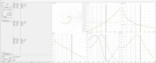

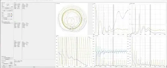

Below are the results from a NanoVNA (from nanovna-saver)
NanoVNA calibrated at load/feedpoint overlaid over NanoVNA calibrated at source/generator end (in blue) with 1:1 choke & 5BTV, RG-213:
And the same chart for the 1:1 choke with 2x100ohm wire-wound resistors in parallel replacing the antenna, VNA calibrated for load-end:
(grey bars are the ham bands from 160M-10M)
I can get an acceptable tune on 80M (narrow-band as it's a coil), and 40M is ok on the low-side, but most other bands aren't usable (too high an SWR, mostly over 4:1 up to > 10:1).
I'm wondering if the SWR curve in the bottom-most image (choke) is what should be expected for 2xFT240-31's? Because the SWR of the choke rises on higher bands, i'm wondering if that's why i'm having trouble getting a tune on the higher bands?

    Wirewound resistors are not a good choice for this frequency range.Their inductance may start to become evident around 40m and will become steadily more significant as you increase frequency. Garden-variety metal-film and carbon-film are more appropriate. – Brian K1LI Oct 06 '20 at 15:33
Directly below the antenna on the pole is a home-made 1:1 choke (2 x FairRite FT240-31's w/11 turns of RG-400 around both toroids). An SO-239 on one side, and 2 bolts, one to centre element of the 5BTV via a 2" wire pigtail, and 1/2 foot wire pigtail to connect to radials below.
I would guess the pigtails and balun are large enough to be significant, and the source of your problem. You can see from your second VNA screenshot that the balun is introducing some significant impedance. If it weren't, the Smith chart should just be a dot in the center, as if you put a 50 ohm load right on the VNA.

Ran a little experiment to try what Phil mentioned, i raised the radial ring from ground-level to just below the balun, and used a shorter (3" or so) pigtail to connect to the radials as a test.
Pigtail between the choke centre-pin and and centre screw on the 5btv is exactly the same pigtail as before (around 3" as well..)
So, the moral of the story is to keep the centre and braid connections short by either using a so-239 and a coax pigtail, or if using wires, keep them as short as possible.
Studying DX Engineerings PDF on the BTV this isn't mentioned explicitly, but one can notice all the intra choke/radial-plate connections are short, wether it's a direct so-239 to the btv itself, a bulkhead so239 on the radial-plate with coax pigtail, or a short tinned copper-braid from DX Engineerings own choke.
The proof is in the pudding :) Thanks to all who provided advice, this is a test setup, now i'll have re-design the pigtails more permanently, soon.
