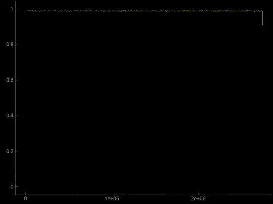

Example 1: The entire binary is obfuscated Full binary obfuscation
The flat, straight line indicates that the entropy level is very close to 1 throughout the entire binary, indicating that there are no un-obfuscated regions.

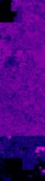

2. Visualization
Visualization can used to very quickly get a sense of the layout of a binary. An entropy plot is arguably one type of visualization: since code and data have different entropy levels, an entropy plot can be used to get a sense of the layout of a binary. For example, file headers typically have low entropy, code has fairly high entropy, and ASCII data has an entropy level between the two.
Visualization of firmware.bin using binvis.io:
Note: blue is ASCII data, pink is entropy close to 1.
byteclass 1 entropy 1 byteclass 2 entropy 2
These images reveal something interesting which was not obvious from the entropy plot: there appears to be an obfuscated block of data in the binary within the same region that ASCII data is concentrated. The pictures below are zoomed in on this region:
enter image description here enter image description here enter image description here enter image description here
This possibly obfuscated block is located at the offset of the entropy spike in the plot:
entropy plot (cropped) firmware entropy (rotated)

Inspecting the region of the binary around offset 0x6EE50 could potentially shed some light on why binwalk is incorrectly detecting an LZMA compression signature:
0006ee38  65 6c 2d 77 6c 61 6e 2d  78 78 78 00 02 04 0b 16  |el-wlan-xxx.....|
0006ee48  00 0c 12 18 24 30 48 60  6c 00 00 00 02 04 0b 0c  |....$0H`l.......| <- 0x6EE50
0006ee58  12 16 18 24 30 48 60 6c  00 00 00 00 0c 12 18 24  |...$0H`l.......$|
0006ee68  b0 48 60 6c 00 00 00 00  00 00 00 00 00 00 00 00  |.H`l............|
0006ee78  00 00 00 00 00 00 00 00  00 00 00 00 00 00 00 00  |................|
0006eea8  00 00 00 00 03 00 00 00  14 00 00 00 0a 00 00 00  |................|
0006eeb8  00 00 00 00 00 00 00 00  00 00 00 00 00 00 00 00  |................|
0006f2b8  00 00 00 00 00 10 00 00  80 00 08 00 08 08 08 00  |................|
0006f2c8  04 41 10 00 84 10 42 00  22 22 22 00 12 91 48 00  |.A....B."""...H.|
0006f2d8  12 49 92 00 92 24 49 01  52 4a 4a 01 4a a5 4a 01  |.I...$I.RJJ.J.J.|
0006f2e8  aa 52 55 01 55 ad aa 00  b5 5a b5 00 ad b5 b5 00  |.RU.U....Z......|
There are quite a few null bytes and repeated characters following the offset of the detected LZMA compression signature. Given that compressed regions have high entropy, this indicates quite strongly that the detected signature was a false positive.

This may or may not be meaningful information. I can't tell.
Conclusion
The point of all of this is to show that signature-based scans have a tendency to produce false positives and also do not detect quite a bit of interesting information contained in firmware binaries (given that they are not obfuscated), and that tools are not a replacement for the brain. Even if a scan produces no output at all there may still be useful information to be found using other methods. There several tools and techniques that can be used to extract interesting or useful information, and one should not become overly reliant on a single tool or method or implicitly trust a tool's output.
