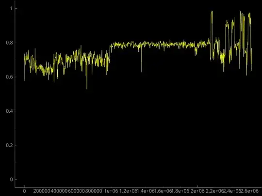

I want to modify the mentioned camera firmware (SJ1000). The binary (.bin) firmware file can be downloaded from archive.org. I used binwalk to scan the binary, but I'm stuck. The binwalk signature scan detects 3 signatures in the binary:
  1. 88K BCS EXECUTABLE
  2. LZMA-compressed data
  3. LZMA-compressed data
The two LZMA compression signatures seem to be false positives, because they have a negative size. I copied the LZMA-compressed data with dd, but I can't unpack it. The LZMA unpacker returns an error message: the file is not valid LZMA compressed data.
As for the 88K BCS EXECUTABLE signature: I don't know what is this. I can copy it with dd, but I can't do anything with this.
What can I do? Is it possible to decompose this file into its constituent parts, or is this impossible?

Always verify the results of a signature scan before attempting extraction.
There are no LZMA-compressed regions in this binary. Here is the output of a signature scan using binwalk v2.1.1:
$ binwalk FW96650A.bin
DECIMAL       HEXADECIMAL     DESCRIPTION
167266        0x28D62         Unix path: /15/20/24/25/30/60/120/240fps can be served..

Here are the results of the entropy analysis:
Entropy scan
$ binwalk -E FW96650A.bin
DECIMAL       HEXADECIMAL     ENTROPY
0             0x0             Falling entropy edge (0.574748)
2158592       0x20F000        Rising entropy edge (0.963265)  <-- JPEG image
2170880       0x212000        Rising entropy edge (0.981137)
2179072       0x214000        Falling entropy edge (0.708192)
2363392       0x241000        Falling entropy edge (0.846409)
2426880       0x250800        Falling entropy edge (0.848443)
2496512       0x261800        Rising entropy edge (0.974327)
2510848       0x265000        Rising entropy edge (0.968564)
2525184       0x268800        Falling entropy edge (0.764579)
2529280       0x269800        Rising entropy edge (0.953455)
2533376       0x26A800        Falling entropy edge (0.717140)
2537472       0x26B800        Rising entropy edge (0.966682)
2543616       0x26D000        Rising entropy edge (0.953760)
2545664       0x26D800        Falling entropy edge (0.763122)
2588672       0x278000        Rising entropy edge (0.960725)
2592768       0x279000        Rising entropy edge (0.967902)
2603008       0x27B800        Rising entropy edge (0.966048)
2609152       0x27D000        Rising entropy edge (0.973450)
2617344       0x27F000        Falling entropy edge (0.749652)
There are some regions of high entropy, but nothing indicating LZMA compression.
