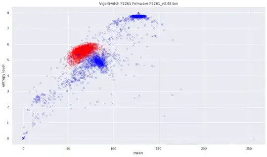

The original answer I posted in 2018 is somewhat out of date now. There are 2 tools that have been released in the meantime that can help with understanding what is in a binary file. One tool, ISAdetect, focuses specifically on identifying the CPU the code in an executable binary targets. It accomplishes this using machine learning.
Another tool, Centrifuge, also uses machine learning, but does not focus on machine code specifically. Rather, this tool was designed to help an analyst identify what kinds of data are encoded in binary files (full disclosure, I am the creator of this tool). To that end, it provides many functions for visualizing the data in a binary file using Python plotting libraries, and finds clusters of statistically-similar data by using scikit-learn's implementation of the DBSCAN algorithm. Centrifuge also uses ISAdetect's web API to identify any machine code found in a binary file.

As you can see from these images, the approach taken by the tool is statistical. It is through statistical analysis of the data in a file that Centrifuge is able to identify what types of data may be present. At time of writing, 3 different data types can be identified: machine code, UTF-english, and compression/encryption.
As an example of this, here is the output for a firmware binary analyzed by Centrifuge:

For context, here is a visualization of the information of the same binary:
firmware clusters
