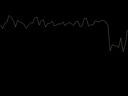

MIPSEL eCos firmware from Analysing eCos image
eCos firmware entropy plot (cropped) entropy visualization detail visualization <------------------------ code -------------------------><---- images, ASCII---->
Unknown instruction set, uC/OS firmware from lzma: File format not recognized [Details enclosed]
CleverDOg camera firmware entropy plot (cropped) entropy visualization detail visualization <-------------------------- code??? ------------------------><-- ASCII -->
Ubicom32 SlingBox firmware from Need help extracting YAFFS from firmware .bin file
SlingBox firmware entropy plot (cropped) entropy visualization detail visualization <--------------------------- code -----------------------> <- data ->< code >
A pattern appears to emerge, no? The executable code in the firmware images presented here is not so difficult to differentiate from data because it largely resides in 1 or 2 large, contiguous blocks.
