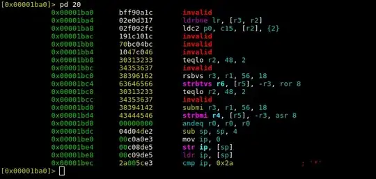

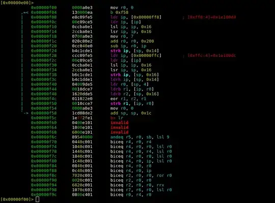

Why is this? A broken instruction causes Capstone to cease disassembly following offset 0xF5C:
By default, Capstone stops disassembling when it encounters a broken instruction. Most of the time, the reason is that this is data mixed inside the input, and it is understandable that Capstone does not understand this "weird" code.
Typically, you are recommended to dertermine yourself where the next code is, and then continue disassembling from that place.1
invalid instructions at offset 0xf60
Above we see that there are indeed invalid instructions following the instruction at offset 0xF5C.
Some of the following data is disassembled as code:
00001ba0  bf f9 0a 1c 02 e0 d3 17  02 f0 92 fc 19 1c 10 1c  |................|
00001bb0  70 bc 04 bc 10 47 c0 46  30 31 32 33 34 35 36 37  |p....G.F01234567|
00001bc0  38 39 61 62 63 64 65 66  30 31 32 33 34 35 36 37  |89abcdef01234567|
00001bd0  38 39 41 42 43 44 45 46  00 00 00 00 04 d0 4d e2  |89ABCDEF......M.|
00001be0  00 c0 a0 e3 00 c0 8d e5  00 c0 9d e5 2a 00 5c e3  |............*.\.|
data disassembled as code

To add to SYS_V's good answer, this 'weird' mixing of code and data is actually very common with ARM code.
ARM instructions are fixed sizes (4 bytes on ARM, 2 bytes for THUMB) and have insufficient space to encode an 32 bit immediate value. Instead, ARM compilers usually do two things -
  1. they place 32 bit immediate constants straight after the instructions for the function in which the constants are needed, and
  2. they use PC-relative load instructions in the function to put these constants into registers.
In SYS_V's disassembly, the instructions at addresses 0x00000F08 and 0x00000F28 are both PC relative loads. (Though the disassembler is being helpful here and displaying the calculated addresses 0x00000FF8 and 0x00000FFC rather than showing [PC,offset].)
The disassembler is further being helpful and annotating the disassembly in red at the side showing the values of the immediate constants that will be loaded. In this case the values loaded are 0x01E100D4 and 0x01E100DC respectively.
It's usual to see the immediate constants stored after the function in order of the addresses of the functions that access them. So, in this case, the function ends with the instruction at 0x00000F5C and the immediate constants would appear to span the address range 0x00000F60 to 0x00000FFF and I would usually expect the following function to begin at address 0x00001000.
Knowing this it would be possible for a disassembler to identify this pattern and automatically skip the associated data.
