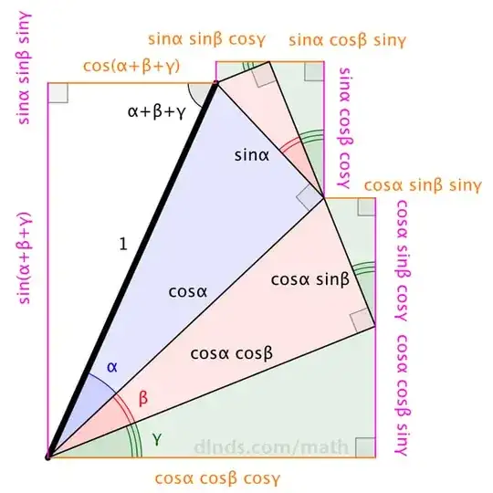

Enhancing my diagram for the angle-sum formula (currently featured in Wikipedia) to use three angles will get you pretty close ...
Thus,
$$\begin{align} \cos(\alpha+\beta+\gamma) &= \cos\alpha \cos\beta \cos\gamma - \sin\alpha \sin\beta \cos\gamma - \sin\alpha \cos\beta\sin\gamma - \cos\alpha \sin\beta\sin\gamma \\ \sin(\alpha+\beta+\gamma) &= \sin\alpha \cos\beta \cos\gamma + \cos\alpha \sin\beta \cos\gamma + \cos\alpha \cos\beta \sin\gamma - \sin\alpha \sin\beta \sin\gamma \end{align}$$
With $\alpha = \beta = \gamma = \theta$, these become ... $$\begin{align} \cos 3\theta &= \cos^3\theta - 3 \sin^2\theta \cos\theta \\ \sin 3\theta &= 3\cos^2\theta \sin\theta - \sin^3\theta \end{align}$$ ... which the Pythagorean identity helps us rewrite as ... $$\begin{align} \cos 3\theta &= \cos^3\theta - 3 (1-\cos^2\theta) \cos\theta = 4\cos^3\theta - 3 \cos\theta \\ \sin 3\theta &= 3(1-\sin^2\theta) \sin\theta - \sin^3\theta = 3\sin\theta - 4\sin^3\theta \end{align}$$
Off-hand, I don't know of a diagram that goes directly from $\cos 3\theta$ to $4\cos^3\theta-3\cos\theta$.

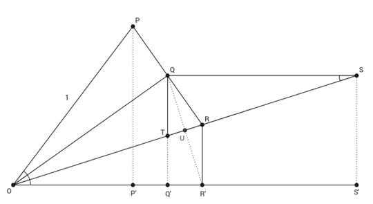

Assemble four congruent right triangles with hypotenuse $1$ and angle $\theta$ as shown:
Diagram
In the diagram, the marked angles are all $\theta$. Since $OQ = \cos\theta$, we have $OU = \cos^2\theta$, so $OS = 2\cos^2\theta$, and so $$ OS' = 2\cos^3\theta $$ On the other hand, $$ OS' = OP' + P'Q' + Q'S' = \cos(3\theta) + P'Q' + \cos(\theta) $$ and $$ OS' = OR' - Q'R' + Q'S' = \cos(\theta) - Q'R' + \cos(\theta) $$ Since $P'Q' = Q'R'$, adding these together yields $$ \cos(3\theta) + 3\cos(\theta) = 2OS' = 4\cos^3\theta $$
I hope the diagram is reasonably self-explanatory, that it's clear what needs to be proved to justify the steps of the argument, and that it's easy to prove those things once you've identified them. But if I've misjudged this, let me know and I'll fill in some more details.

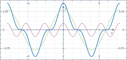

This is not a direct proof but a link to the Fourier series: $4\cos^3\theta=3\cos\theta+\cos3\theta$.
Similarly, for the fifth power: $16\cos^5\theta=10\cos\theta+5\cos3\theta+\cos5\theta$.
The main lesson is that to represent the $k^{th}$ power, the odd harmonics from $1$ to $k$ suffice.
The explanation is not so difficult: the Fourier coefficients are computed from the integrals $$\int_0^{2\pi}\cos^k\theta\ e^{in\theta}d\theta=\int_0^{2\pi}\left(\frac{e^{i\theta}-e^{-i\theta}}2\right)^ke^{in\theta}d\theta.$$ When developing, the lowest exponent of $e^{i\theta}$ is $n-k$. If $n>k$, the integrand is oscillatory and the integral vanishes.
If you admit that, then $\cos^3\theta=a\cos\theta+b\cos3\theta$.
From the figure, at $\theta=0$ the values add up to $1$ and at $\theta=\pi/2$ the slopes cancel out, so that $$a+b=1\\a-3b=0,$$ $$\cos^3\theta=\frac34\cos\theta+\frac14\cos3\theta.$$
Similarly, $\cos^5\theta=a\cos\theta+b\cos3\theta+c\cos5\theta$, at $\theta=0$ the values add up to $1$ and at $\theta=\pi/2$ the first and third derivatives cancel out, so that $$a+b+c=1\\ a-3b+5c=0\\ a-27b+125c=0,$$ $$\cos^5\theta=\frac{10}{16}\cos\theta+\frac{5}{16}\cos3\theta+\frac{1}{16}\cos5\theta.$$
