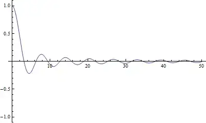

In this wikipedia article for improper integrals, $$ \int_0^{\infty}\frac{\sin x}{x}dx $$ is given as an example for the integrals that have an improper Riemann integral but do not have a (proper) Lebesgue integral. Here are my questions:
  • Why does this one have an improper Riemann integral? (I don't see why $\int_0^a\frac{\sin x}{x}dx$ and $\int_a^{\infty}\frac{\sin x}{x}dx$ converge.)
  • Why doesn't this integral have a Lebesgue integral? Is it because that $\frac{\sin x}{x}$ is unbounded on $(0,\infty)$ and Lebesgue integral doesn't deal with unbounded functions?
    $\int_0^a\frac{\sin x}xdx$ converges since we can extend the function $x\mapsto \frac{\sin x}x$ by continuity at $0$ (we give the value $1$ at $0$). To see that the second integral converges, integrate by parts $\int_a^A\frac{\sin x}x dx$. But $f(x):=\frac{\sin x}x$ has not a Lebesgue integral, since the integral $\int_0^{\infty}\left|\frac{\sin x}x\right| dx$ is not convergent (but it's not a consequence of the fact that $f$ is not bounded, for example that $g(x)=\frac 1{\sqrt x}$ for $0<x\leq 1$ and $g(x)=0$ for $x>1$). – Davide Giraudo Sep 24 '11 at 14:48

The integral is not absolutely convergent. Because $$ \int_{k\pi}^{(k+1)\pi}|\sin(t)|\;\mathrm{d}t=2\tag{1} $$ we have $$ \frac{2}{(k+1)\pi}\le\int_{k\pi}^{(k+1)\pi}\left|\frac{\sin(t)}{t}\right|\;\mathrm{d}t\le\frac{2}{k\pi}\tag{2} $$ Since the harmonic series diverges, so does the integral of the absolute value. Therefore, the Lebesgue integral does not exist.
However, the improper Riemann integral $$ \int_0^\infty\frac{\sin(t)}{t}\mathrm{d}t\tag{3} $$ does exist. To see this, note that $$ \int_{2k\pi}^{2(k+1)\pi}\sin(t)\;\mathrm{d}t=0\tag{4} $$ With $a=\frac12\left(\frac{1}{2k\pi}+\frac{1}{2(k+1)\pi}\right)$, and using $(1)$ and $(4)$, we get $$ \begin{align} \left|\int_{2k\pi}^{2(k+1)\pi}\frac{\sin(t)}{t}\mathrm{d}t\right| &=\left|\int_{2k\pi}^{2(k+1)\pi}\sin(t)\;\left(\frac1t-a\right)\;\mathrm{d}t\right|\\ &\le\int_{2k\pi}^{2(k+1)\pi}\left|\sin(t)\right|\;\mathrm{d}t\;\max_{[2k\pi,2(k+1)\pi]}\left(\frac1t-a\right)\\ &=4\cdot\frac12\left(\frac{1}{2k\pi}-\frac{1}{2(k+1)\pi}\right)\\ &=\frac{1}{k(k+1)\pi}\tag{5} \end{align} $$ Furthermore, we have the telescoping series $$ \begin{align} \sum_{k=1}^\infty\frac{1}{k(k+1)} &=\sum_{k=1}^\infty\frac{1}{k}-\frac{1}{k+1}\\ &=1\tag{6} \end{align} $$ Thus, $(2)$, $(5)$, and $(6)$ guarantee that $$ \int_{2\pi}^\infty\frac{\sin(t)}{t}\mathrm{d}t\tag{7} $$ converges to a value no greater than $\dfrac1\pi$.
Since $\left|\dfrac{\sin(t)}{t}\right|\le1$, $$ \int_0^{2\pi}\frac{\sin(t)}{t}\mathrm{d}t\tag{8} $$ has a value no greater than $2\pi$.
$(7)$ and $(8)$ guarantee that $$ \int_0^\infty\frac{\sin(t)}{t}\mathrm{d}t\tag{9} $$ converges to a value no greater than $2\pi+\dfrac1\pi$.
Another general test is the Dirichlet test (Theorem 17.5). It says that if $$ \left|\int_a^xf(t)\;\mathrm{d}t\right|<M $$ independent of $x\in[a,\infty)$, and $g(x)$ monotonically decreases to $0$ as $x\to\infty$, then $$ \int_a^\infty f(t)g(t)\;\mathrm{d}t $$ converges.
In this case, $$ \left|\int_0^N\sin(t)\;\mathrm{d}t\right|\le2 $$ and $\dfrac1t$ is monotonically decreasing to $0$ on $(0,\infty)$. Thus, by Dirichlet, $$ \int_0^\infty\frac{\sin(t)}{t}\mathrm{d}t $$ converges.
In fact, contour integration yields that $$ \int_{-\infty}^\infty\frac{\sin(t)}{t}\mathrm{d}t=\pi $$ which, by symmetry, tells us that $$ \int_0^\infty\frac{\sin(t)}{t}\mathrm{d}t=\frac{\pi}{2} $$

What's more, the second question is somehow incorrect: $\frac{\sin x}{x}$ is bounded on $(0,\infty)$:

Recall that all Riemann-integrable functions are defined on a closed interval $[a,b]$ and are bounded there. Hence the integral $\int_0^a \frac{\sin(x)}{x} dx$ has a problem with the definition of integral. However, the integrand can be extended to $\mathbb{R}$ by defining the value $1$ at $0$. Now the extension is Riemann-integrable over $[0,a]$ because it is continuous by the properties of $\frac{\sin(x)}{x}$: it is continuous on $(0,a]$ as product of analytic functions. In addition it has the limit $1$ at $0$ (recall derivation of derivatives of trigonometric functions). Hence it is continuous on the interval $[0,a]$. The extension can be expressed in terms of the sine cardinal function by $\textrm{sinc}(x/\pi)$, where
$\textrm{sinc}(x) = \Bigg\{\begin{eqnarray} & \frac{\sin(\pi x)}{\pi x} & , \ \ x \neq 0 \\ & 1 & , \ \ x = 0 \end{eqnarray}$.
Because of its existence on the interval $[0,a]$ the expression $\textrm{sinc}(x/\pi)$ is used here as the integrand. Because of the definitions in my studybooks there is left the $\pi$ in the definition of $\textrm{sinc}(x)$. It is cancelled in the integrand expression. Now $\int_0^a \textrm{sinc}(x/\pi) dx$ exists for every $a\in \mathbb{R}^+$.
Consider now the integral $\int_a^M \frac{\sin(x)}{x} dx$. We have \begin{eqnarray} \frac{|\cos(x)|}{x^2} \leq \frac{1}{x^2} \ , \ \ x \geq a . \end{eqnarray} The right hand side is a majorant to the non-negaitve left hand side. The right hand side is also integrable from $a$ to $\infty$. Hence also the left hand side is. This implies the existence of $\int_a^\infty \frac{\cos(x)}{x^2} dx$. We now have \begin{eqnarray} \int_a^M \frac{\sin(x)}{x} dx & = & \Bigg|_a^M \frac{-\cos(x)}{x}-\int_a^M -\frac{-\cos(x)}{x^2} dx \\ & = & \frac{\cos(a)}{a}-\frac{\cos(M)}{M}-\int_a^M \frac{\cos(x)}{x^2} dx \end{eqnarray} for $M \geq a$. All terms on the right hand side have a limit as $M \rightarrow \infty$. Hence the integral $\int_a^\infty \frac{\sin(x)}{x} dx$ exists for every $a \in \mathbb{R}^+$. Hence we can write \begin{eqnarray} \int_0^a \textrm{sinc}(x/\pi) dx + \int_a^\infty \frac{\sin(x)}{x} dx & = & \int_0^a \textrm{sinc}(x/\pi) dx + \int_a^\infty \textrm{sinc}(x/\pi) dx \\ & = & \int_0^\infty\textrm{sinc}(x/\pi) dx \ . \end{eqnarray} Now all terms on the left hand side exist. Hence also the right hand side.
Then we analyze the existence of the respective Lebesgue integral. Recall that by definition of the Lebesgue integral it is obtained by substraction from the integrals of the positive and the negative part. The claim is that the integral diverges and we have to show that at least one of the integrals of the positive and the negative part diverge. We choose the positive part \begin{eqnarray} f^+(t) = \chi_{\bigcup_{k=0}^\infty[2\pi k, 2\pi (k+1/2)]} \textrm{sinc}(x/\pi) \ . \end{eqnarray} Note that we can write a diverging lower limit estimate for Lebesgue integral because it accepts the value of $\infty$. We calculate \begin{eqnarray} \int_{\mathbb{R} \textrm\ \mathbb{R}^-} f^+(x) d\mu & = & \int_{\mathbb{R} \textrm\ \mathbb{R}^-} \chi_{\bigcup_{k=0}^\infty [2\pi k, 2\pi (k+1/2)]} \textrm{sinc}(x/\pi) d\mu \\ & \geq & \int_{\mathbb{R} \textrm\ \mathbb{R}^-} \chi_{\bigcup_{k=0}^n [2\pi k,2\pi (k+1/2)]} \textrm{sinc}(x/\pi) d\mu \\ & = & \sum_{k=0}^n \int_{[2\pi k, 2\pi(k+1/2)]} \textrm{sinc}(x/\pi) d\mu \\ & = & \sum_{k=0}^n \int_{2\pi k}^{2\pi (k+1/2)} \textrm{sinc}(x/\pi) dx \\ & = & \int_0^\pi \textrm{sinc}(x/\pi) dx + \sum_{k=1}^n \int_{2\pi k}^{2\pi (k+1/2)} \textrm{sinc}(x/\pi) dx \\ & = & \int_0^\pi \textrm{sinc}(x/\pi) dx + \sum_{k=1}^n \int_0^\pi \textrm{sinc}((x+2\pi k)/\pi) dx \\ & = & \int_0^\pi \textrm{sinc}(x/\pi) dx + \sum_{k=1}^n \int_0^\pi \frac{\sin(x+2\pi k)}{x+2\pi k} dx \\ & \geq & \int_0^\pi \textrm{sinc}(x/\pi) dx + \sum_{k=1}^n \int_0^\pi \frac{\sin(x)}{\pi + 2\pi k} dx \\ & = & \int_0^\pi \textrm{sinc}(x/\pi) dx + \sum_{k=1}^n \frac{1}{\pi+2\pi k} \Bigg|_0^\pi -\cos(x) dx \\ & \geq & \int_0^\pi \textrm{sinc}(x/\pi) dx + \sum_{k=1}^n \frac{2}{2\pi(k+1)} \\ & = & \int_0^\pi \textrm{sinc}(x/\pi) dx + \frac{1}{\pi} \sum_{k=2}^{n+1} \frac{1}{k} \ . \end{eqnarray} for every $n > 0$. The harmonic sum diverges as $n \rightarrow \infty$. Hence the left hand side equals to $\infty$. This shows the claim. Similar analysis shows that also the integral of the negative part diverges. Hence the Lebesgue integral has the form $\infty - \infty$ that is not defined, that is, the Lebesgue integral of $\textrm{sinc}(x/\pi)$ doesn't exist. However, the Lebesgue integral of $|\textrm{sinc}(x/\pi)|$ exists and equals to $\infty$.
The function $\textrm{sinc}(x/\pi)$ is bounded because it is continuous on $[0,a]$ and hence bounded there and has an upper limit estimate $\frac{1}{a}$ on $[a,\infty)$. The divergence is not due to any singularities of $\textrm{sinc}(x/\pi)$ but because of the too slowly decreasing factor $\frac{1}{x}$ of the integrand and periodicity of $\sin(x)$.
