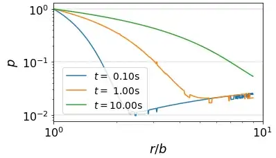

I computed the solution with scipy, and obtained the same results as Ron Gordon (fortunately!), as shown in the figure ($b = r_D$). The integration is somehow off for large values of $r/b$. Depending on the case, it may be relevant or not.
