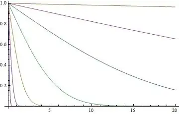

where erfc is the complementary error function. Here is a plot of the temperature over $x$ for various values of $t$:
Note that the temperature is fixed at $x=0$. Also note that,over time, the heat distributes over $x$ until, eventually, the temperature becomes uniform.

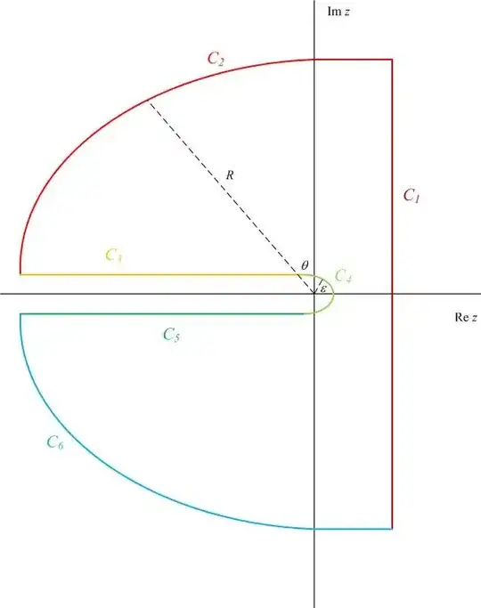

Consider the following integral in the complex $z$ plane:
$$\oint_C \frac{dz}{z} \exp{(-\sqrt{a z})} \exp{(t z)} $$
where $a>0$ and $C$ is the following contour:
We will define $\text{Arg}{z} \in (-\pi,\pi]$, so the branch is the negative real axis. There are $6$ pieces to this contour, $C_k$, $k \in \{1,2,3,4,5,6\}$, as follows.
$C_1$ is the contour along the line $z \in [c-i R,c+i R]$ for some large value of $R$.
$C_2$ is the contour along a circular arc of radius $R$ from the top of $C_1$ to just above the negative real axis.
$C_3$ is the contour along a line just above the negative real axis between $[-R, -\epsilon]$ for some small $\epsilon$.
$C_4$ is the contour along a circular arc of radius $\epsilon$ about the origin.
$C_5$ is the contour along a line just below the negative real axis between $[-\epsilon,-R]$.
$C_6$ is the contour along the circular arc of radius $R$ from just below the negative real axis to the bottom of $C_1$.
We will show that the integral along $C_2$and $C_6$ vanish in the limits of $R \rightarrow \infty$ and $\epsilon \rightarrow 0$.
