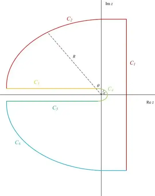

You can use a contour integration without that substitution as follows by deforming the Bromwich contour about the negative real axis and exploiting a branch cut of $\sqrt{z}$ about that axis. So, consider the integral
$$\oint_C dz \: e^{-\sqrt{z}} e^{z t}$$
where $C$ is a keyhole contour about the negative real axis, as pictured below.
We will define $\text{Arg}{z} \in (-\pi,\pi]$, so the branch is the negative real axis. There are $6$ pieces to this contour, $C_k$, $k \in \{1,2,3,4,5,6\}$, as follows.
$C_1$ is the contour along the line $z \in [c-i R,c+i R]$ for some large value of $R$.
$C_2$ is the contour along a circular arc of radius $R$ from the top of $C_1$ to just above the negative real axis.
$C_3$ is the contour along a line just above the negative real axis between $[-R, -\epsilon]$ for some small $\epsilon$.
$C_4$ is the contour along a circular arc of radius $\epsilon$ about the origin.
$C_5$ is the contour along a line just below the negative real axis between $[-\epsilon,-R]$.
$C_6$ is the contour along the circular arc of radius $R$ from just below the negative real axis to the bottom of $C_1$.
We will show that the integral along $C_2$,$C_4$, and $C_6$ vanish in the limits of $R \rightarrow \infty$ and $\epsilon \rightarrow 0$.

On $C_4$, the integral vanishes as $\epsilon$ in the limit $\epsilon \rightarrow 0$. Thus, we are left with the following by Cauchy's integral theorem (i.e., no poles inside $C$):
$$\left [ \int_{C_1} + \int_{C_3} + \int_{C_5}\right] dz \: e^{-\sqrt{z}} e^{z t} = 0$$
On $C_3$, we parametrize by $z=e^{i \pi} x$ and the integral along $C_3$ becomes
$$\int_{C_3} dz \: e^{-\sqrt{z}} e^{z t} = e^{i \pi} \int_{\infty}^0 dx \: e^{-i \sqrt{x}} e^{-x t}$$
On $C_5$, however, we parametrize by $z=e^{-i \pi} x$ and the integral along $C_5$ becomes
$$\int_{C_5} dz \: e^{-\sqrt{z}} e^{z t} = e^{-i \pi} \int_0^{\infty} dx \: e^{i \sqrt{x}} e^{-x t}$$
We may now write
$$-\frac{1}{i 2 \pi} \int_0^{\infty} dx \: e^{- x t} \left ( e^{i \sqrt{x}} - e^{-i \sqrt{x}} \right ) + \frac{1}{i 2 \pi} \int_{c-i \infty}^{c+i \infty} ds \: e^{-\sqrt{s}} e^{s t} = 0$$
Therefore, the ILT of $\hat{f}(s) = e^{-\sqrt{s}}$ is given by
$$\begin{align}\frac{1}{i 2 \pi} \int_{c-i \infty}^{c+i \infty} ds \: e^{-\sqrt{s}} e^{s t} &= \frac{1}{i 2 \pi} \int_0^{\infty} dx \: e^{- x t} \left ( e^{i \sqrt{x}} - e^{-i \sqrt{x}} \right )\\ &= \frac{1}{\pi} \int_{-\infty}^{\infty} du\: u \,e^{-t u^2} \sin{u}\end{align}$$
The last step involved substituting $x=u^2$ and exploiting the evenness of the integrand. This integral may be evaluated as follows:
$$\begin{align}\frac{1}{\pi} \int_{-\infty}^{\infty} du\: u \,e^{-t u^2} \sin{u} &= \frac{1}{\pi} \Im{\left [\int_{-\infty}^{\infty} du\:u\, e^{-t u^2} e^{i u} \right]}\\ &= \frac{1}{\pi} \Im{\left [\int_{-\infty}^{\infty} du\:u\, e^{-t (u-i/(2 t))^2} e^{-1/(4 t)}\right ]}\\ &= \frac{1}{\pi} e^{-1/(4 t)} \Im{\left [\int_{-\infty}^{\infty} dv \: \left ( v + \frac{i}{2 t} \right ) e^{-t v^2} \right]}\\ &= \frac{1}{\pi} e^{-1/(4 t)} \frac{1}{2 t} \sqrt{\frac{\pi}{t}} \end{align}$$
Therefore the result is that
$$\mathcal{L}^{-1}[e^{-\sqrt{z}}](t) = \frac{1}{i 2 \pi} \int_{c-i \infty}^{c+i \infty} dz \: e^{-\sqrt{z}} e^{z t} = \frac{1}{2 \sqrt{\pi}} t^{-3/2} e^{-\frac{1}{4 t}}$$
as was to be shown.

Could you explain how you get this: On $C_2$, the real part of the argument of the exponential is $R t \cos{\theta} - \sqrt{R} \cos{\frac{\theta}{2}}$. – BPm Apr 21 '14 at 03:54
2@BPm: Plug in $z=R e^{i \theta}$. The integrand then takes the form $$e^{R t e^{i \theta} - \sqrt{R} , e^{i \theta/2}}$$ – Ron Gordon Apr 21 '14 at 05:00
