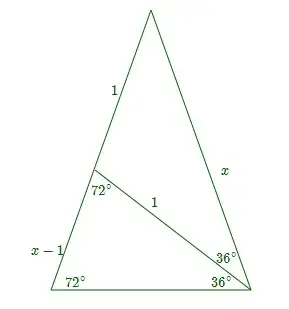

Consider the isosceles triangle pictured below:
By considering similar triangles, one has ${x\over 1}={1\over x-1}$. From this, it follows that $x={1+\sqrt 5\over 2}$. Drop a perpendicular from the top vertex to the base below. One sees that $\sin(18^\circ)={1\over 1+\sqrt 5}={\sqrt 5-1\over 4}$. Now use the Pythagorean Identity to find $\cos(18^\circ)$.
