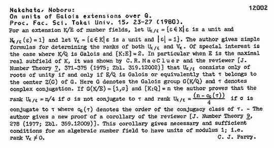

The answer to your question is no - not all algebraic integers with absolute value 1 are roots of unity - as you may have learned by now from the 2005 paper of Daileda that was referenced in the answer supplied by Robin Chapman. However, you should be aware that Daileda has in fact rediscovered these simple folklore results on unimodular units. These results are probably at least a half-century old - if not much older. Indeed, I recall reading similar results in papers published by Iwasawa in the fifties or sixties. I don't have the time now to locate said Iwasawa reference, but here is another reference that suffices to prove my point. This 1979 paper of Nakahata includes the same results and the same simple proofs found in Daileda's paper. Moreover, Nakahata places these results naturally into a more general context. Thus I highly recommend that you consult Nakahata's paper in addition to Daileda's. I've appended its Zbl review below.
