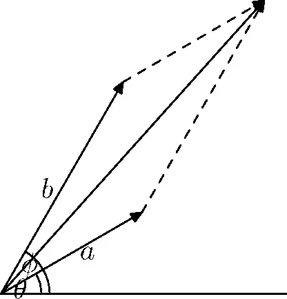

We have situation as in the following picture: enter image description here
Note that the $y$-coordinates of the two vectors are precisely the values you want to add together. So we would like to know the length and the angle for the sum of these two vectors.

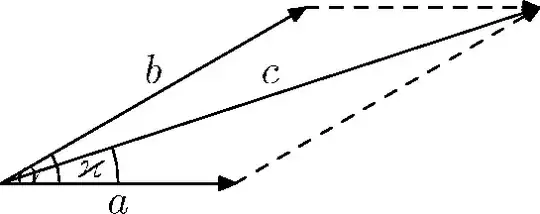

We simply rotate the situation. We denote $\alpha=\phi-\theta$. enter image description here
We want to find the values $c$ and $\varkappa$. Once we know them, we get $$a\sin\theta+b\sin\phi= c\sin(\theta+\varkappa).$$
For $c$ we can simply use law of cosines: $$c^2=a^2+b^2+2ab\cos\alpha$$ (Note that the angle in the bottom triangle is $\pi-\alpha$.)
We can calculate $\varkappa$ using law of sines: $$\frac{\sin(\pi-\alpha)}{\sin\varkappa} = \frac cb \qquad \Rightarrow \qquad \sin\varkappa=\frac{b\sin\alpha}c$$
Note that this does not determine $\varkappa$ uniquely, but you can find out whether $\varkappa>\pi/2$ or $\varkappa<\pi/2$ by checking the sign of $x$-coordinate of the sum of the two vectors, which is $a+b\cos\alpha$.
