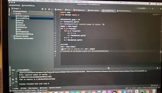

  3. Most interestingly Fermat numbers also included in representing the angles like $2\cos\frac{2}{5}\pi$, $2\cos\frac{8}{17}\pi$, $2\cos\frac{128}{257}\pi$, $2\cos\frac{32768}{65537}\pi$... can be represented as cyclic infinite nested square roots of 2 as follows $cin\sqrt2[1-1+]$, $cin\sqrt2[1-3+]$,$cin\sqrt2[1-7+]$,$cin\sqrt2[1-15+]$... Respectively ( Deriving the values with python program will be effortless for the angles like $2\cos\frac{\pi}{65537}$ which otherwise look very much complicated
(The code below required very small fraction of a second to calculate $2\cos\frac{32768}{65537}\pi$)
Python code for solving $2\cos\frac{32768}{65537}\pi$ Python code 4. Conventionally we don't have exact representation of angles like $\cos\frac{\pi}{7}$, $\cos\frac{\pi}{11}$. But intuitively or with some effort these can be derived and represented as cyclic infinite nested square roots of 2.
