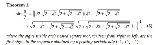

In the article "The unruly $\sin (\pi/7)$ of Samuel Moreno, the following infinite product is given: enter image description here
Also, the same article shows that $\sin (\pi/7)$ is equal to the infinite nested radical
$ \sin (\pi/7) = \frac{1}{2}\sqrt{2 - \sqrt{2 - \sqrt{2 - \sqrt{2 + \sqrt{2 - \sqrt{2 - \sqrt{2 + \sqrt{2 - \sqrt{2 - \sqrt{2+...}}}}}}}}}}$
The question is: are these two expressions fundamentally different for $\sin(\pi/7)$, or is it possible to rewritte the infinite nested radical into that infinite product by simple algebraic manipulations?

Let: $$ \begin{align} \LARGE{\rho}\normalsize &= \left(\small \sqrt{2} \,\sqrt{2-\sqrt{2}} \,\sqrt{2+\sqrt{2-\sqrt{2}}} \normalsize\right) \times \\[2mm] & \space \left(\small \sqrt{2\color{red}{-}\sqrt{2+\sqrt{2-\sqrt{2}}}} \,\sqrt{2\color{red}{-}\sqrt{2-\sqrt{2+\sqrt{2-\sqrt{2}}}}} \,\color{red}{\sqrt{2+ \color{black}{\sqrt{2-\sqrt{2-\sqrt{2+\sqrt{2-\sqrt{2}}}}}}}} \normalsize\right) \times \cdots \\[4mm] \LARGE{\sigma}\normalsize &= \color{red}{\sqrt{2- \color{black}{\sqrt{2-\sqrt{2-\sqrt{2+\sqrt{2-\sqrt{2-\sqrt{2+\sqrt{\cdots}}}}}}}}}} \space\space\small\{\text{Same as last item of}\,\rho\,\text{with minus sign}\} \end{align} $$ Fundamentally, the two expressions are the same.
And to transpose between them, we use the property: $$ \boxed{ \quad \color{red}{\Large{\rho \cdot \sigma = 2}} \quad } \\[4mm] \frac{1}{\rho} = \frac{1}{\rho} \color{red}{\cdot \frac{\sigma}{\sigma}} = \frac{\sigma}{\rho\cdot\sigma} = \frac{\sigma}{2} = \quad\sin\left(\frac{\pi}{7}\right)\quad = \frac{\sigma}{2} = \frac{\sigma}{2} \color{red}{\cdot \frac{\rho}{\rho}} = \frac{\rho\cdot\sigma/2}{\rho} = \frac{1}{\rho} $$
