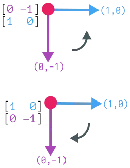

Why skew-symmetric?
What does it mean that the tangent space at the identity $T_I G$ of the group of rotations are the skew-symmetric matrices?
One explanation is to think of these as curl, where a curl is a sort of "infinitesimal rotation". See that a skew symmetric matrix $S \equiv \begin{bmatrix} a & b \\ -b & a \end{bmatrix}$
can be viewed as having two vectors $S_1 = (a, b)$ and $S_2 = (-b, a)$, which represents an infinitesimal rotation from $(a, b)$ to $(-b, a)$.
This is skew-symmetric because rotations in 2D have an orientation. Flipping the order of the vectors gives us the rotations in the opposite order: It takes clockwise to anti-clockwise and anti-clockwise to clockwise. If we wish to fancy, we can talk about this in terms of exterior algebra
See the picture which shows the skew-symmetric matrix $\begin{bmatrix} 0 & 1 \\ -1 & 0 \end{bmatrix}$ and its transpose as "2D orientations"
diagram-skew-symmetric

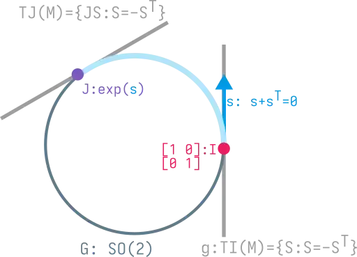

Recap We saw the following equivalences:
  • We have a Lie group $G$ with Lie algebra $\mathfrak g$, which is the tangent space at the identity $T_I G$.
  • For this, computing the Lie algebra by using the "curves" definition co-incides with simply invoking $\log: G \rightarrow \mathfrak g$ on the definiton of the matrix group.
  • Vice versa, the $\exp$ (inverse of $\log$) can be computed from the series definition, giving us a map $\exp: \mathfrak g \rightarrow G$.
  • These maps allow us to go from the "local behaviour" to the "global behaviour".
  • We gained an intuition for the concrete case of $G = SO(2)$, $\mathfrak g$ as skew-symmetric matrices, and why skew-symmetric matrices are the "infinitesimal rotations"
  • We refer to the fact that if we know $\mathfrak g$/$T_I G$, we automatically know all tangent spaces due to the group being a Lie group. Hence, knowing the lie algebra $\mathfrak g$ is "as good as" knowing the tangent space structure everywhere.
A summary picture: summary-relationships
