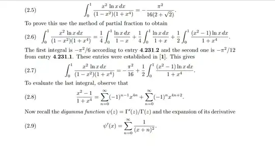

Recently I asked a similar question $\int_{0}^{1}\frac {x^2\ln x}{{(1-x^2)}{(1+x^4)}}dx=\frac{-π^2}{16(2+\sqrt{2})}$
Below the above question a note is written as follows:
'The reader should evaluate the family of integrals ${I_{n}=\int_{0}^{1}\frac {x^{2n}\ln x}{{(1-x^2)}{(1+x^4)^n}}dx{,n} \in N}$ .The computation of the first few special values indicates an interesting arithmetic structure of the answer.’
I don't know how to tackle ${I_{n}}$ till now.
Edit:- Here is the link for above document http://emmy.uprrp.edu/lmedina/papers/part27/final27.pdf
I have searched all the references mentioned in above document but found nothing related to above integral.We might have to look values for different values of $n$ instead of finding integral for general $n$.
