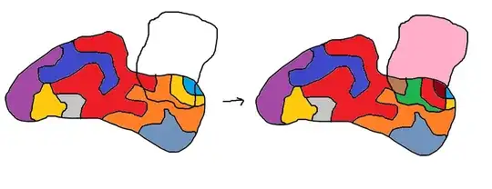

Proof by picture:
Take a collection of finitely many disjoint elements of the sigma algebra. Then the picture below shows gives some intuition as to why one can always add a element to this set of pairwise dijoint sets.
Once you have a infinite collection of pairwise disjoint sets one can identify each of these as distinct elements where unions of sets are also distinct. So by taking all countable unions on this collection one would generate a set with uncountably many elements as it is the power set of a countable set.
asd
  • 111
    How do we know we don't get stuck in choosing some finite family of sets that happens to cover everything, making the choice of the "next" element impossible? – hardmath Oct 04 '14 at 15:35
    Easy, we have an infinite collection of sets in our $\sigma$ algebra. There are only a finite number of sets that can be unions of sets from our collection $2^k$ for a collection of k disjoint sets. Thus we can find a set that is not the union of these sets and thus it's complement intersected with a set in the collection and itself intersected with a set are nonempty and disjoint. – asd Oct 04 '14 at 15:43
    But even if we have an infinite collection of sets, a finite number of them might cover the union of all of them. While a $k$ cardinality family of disjoint subsets form only a finite number of unions, and we can pick a subset distinct from these, that doesn't show the one we pick will not be contained in their union. – hardmath Oct 04 '14 at 15:51
    I think I might understand your concern. The idea the picture is meant to convey is not quite "adding" but "carving" instead. If some set A is contained in their union but not equal to their union for some subcollection then it follows that $A^\complement \cap B_n$ is non-empty which is in the σ algebra and disjoint with $A \cap B_n$ also being in the $\sigma$ algebra. Now of course we have to replace the sets containing some part of A with their respective intersection with the complement of A, and intersection with A. – asd Oct 04 '14 at 16:23
