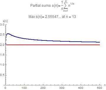

I tried to post this answer to the question How to solve $\lim_{n \to \infty} \frac{n+n^{\frac{1}{2}}+n^{\frac{1}{3}}+...+n^{\frac{1}{n}}}{n}$. Then I noticed that it was a duplicate of the present one. Having seen that my solution method did not yet appear here I add it.
Answer
The limit in question is 2.
The graph depicts the partial sums for $n= 1..500$.
Notice that there is a maxiumum at $n=13$ and that the limit $s(\infty)=2$ is approached from above and very slowly.
