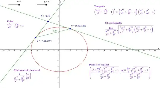

Standard results are summarized in the diagram below where $A(x',y')$ is the pole, $B(x_1,y_1)$ and $C(x_2,y_2)$ are the points of contact.
