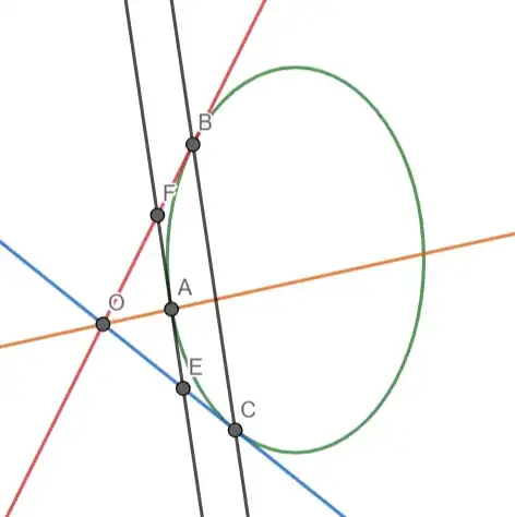

Today I wrote an answer to a question in regards to the topic of shortest distance between a point and a curve, more precisely an ellipse, check here. Turns out the answer was incorrect, yet it was a close approximation, so it sparked an interesting discussion in the comments.
TLDR
My logic for finding a shortest distance from a specific point to an ellipse was to find tangent lines from that point to an ellipse and from there to find a line of symmetry of those two lines. That line of symmetry would intersect the ellipse and would be perpendicular to it, meaning that it should have given me the correct distance. Instead I got an estimate that was accurate up to the third decimal (might be because of rounding up because later when I checked with more decimal points it was incorrect at the second decimal).
For some backstory, I'm not sure how I got this idea. I've seen it used a few times with a circle (couldn't give you any examples right now) so I thought, using similar logic, that the same could be applied to an ellipse, but I guess I should of proved it beforehand.
Let's take a look at the logic I used. I will visualize things for easier understanding.
In the following text, I'll bold possibly incorrect statements. As you can see in the drawn out image, from point $O$ there are two tangent lines, let's denote them as $t_1, t_2$, to an ellipse that touch it at points $B$ and $C$, respectively. Then there is a line of symmetry between the lines $t_1$ and $t_2$, we'll call it $s$. Similarly to the circle the, we can say that $\pmb{\overline{OB}=\overline{OC}}$, meaning $\pmb{\triangle{OBC}}$ is isosceles. Now let's draw a line parallel to the one passing through $B$ and $C$ such that it passes through point $A$ and it is tangent of an ellipse (this is the most questionable statement). Now since all the lines of a triangle $\triangle OEF$ and $\triangle OBC$ are parallel it means they are similar, as such $\pmb{\triangle OEF}$ is isosceles. Because $s$ is a line of symmetry between two lines defined by two sides of $\triangle OEF$, it means that $s$ is line of symmetry of $\angle OEF$, from the fact that it is isosceles triangle, we can conclude that $\pmb{\overline{OA}}$ is the height of $\pmb{\triangle OEF}$. As such, we can say that it is perpendicular to the tangent of an ellipse passing through $\pmb A$.
You can see that all of the bolded points were directly related to one of two:
$1.$ $\overline{OB}=\overline{OC}$,
$2.$ Line parallel to the one passing through $B$ and $C$ such that it passes through point $A$ is tangent of an ellipse.
My question is if you could prove or disprove both or any of these two statements (for example prove the correct one and disprove the incorrect one) which most likely led me to a mistake.

    $OB=OC$ is false, in general. – NDB Jul 17 '23 at 01:08
  • Please, use descriptive titles. "Finding an error in the made assumption" says nothing about the subject of the question. – jjagmath Jul 17 '23 at 03:26
  • @NDB doesn't mean much withouth proof. – bb_823 Jul 17 '23 at 09:07
  • @jjagmath changed it. – bb_823 Jul 17 '23 at 09:07
    NDB explained the problem: the two tangents usually don't have the same length. As an easy to understand counterexample consider the ellipse defined by the equation $x^2+4y^2=4$. If $O=(2,1)$, then the two tangent are the vertical $x=2$ and the horizontal $y=1$, meeting the ellipse at the end points of the semiaxes $B=(0,1)$ and $C=(2,0)$. These are at distances $2$ and $1$ from $O$ respectively. – Jyrki Lahtonen Jul 17 '23 at 09:42
  • For a more general approach I would use the following, based on the implicit function theorem. At an extremal point $A$ we, indeed, have that the tangent to the curve is perpendicular to the is perpendicular to the line segment $OA$. This is also equivalent to the technique of finding constrained extrema of a function (here $|OA|^2$ with $A$ constrained to the curve). This does require that the curve is given implicitly as the zero locus of a function. – Jyrki Lahtonen Jul 17 '23 at 09:48
  • (cont'd) Of course, if you have a (useful) parametrization, $x=x(t)$, $y=y(t)$, of the curve, then you can use methods from single variable calculus, and find the extremal points of the function $f(t):=(x_O-x(t))^2+(y_O-y(t))^2.$ – Jyrki Lahtonen Jul 17 '23 at 09:50
  • @JyrkiLahtonen in regards to your second comment, let's denote the point of intersection of line of symmetry and curve as $A$ and extremal point of the curve as $A_1$. Would that mean that the error function could be represented in sume way as a function of $\angle{A_1OA}$? – bb_823 Jul 19 '23 at 00:13

To disprove the first statement:
Take the tangents that are parallel to the long and short axes of the ellipse. They intersect to a point (O) that is not at equal distance to the contact points B and C of the tangents with the ellipse. So OB ≠ OC.
The Quark
  • 267
  • Ok, thank you. But what how to find a general formula for estimating error between real result and result that someone you'd get using (wrong) method I used? What are all the variables that would affect the estimation in such way? – bb_823 Jul 19 '23 at 23:03
  • @bb_823 Just some random thoughts here: Think of the ellipse as a tilted disc compared to the plan of observation, and think of the point as a line perpendicular to the plan. In this set-up, your reasoning should be correct if applied between the disc and the line in the plan of the disc. How is it affected by applying it in a plan perpendicular to the line? I would say it depends on how the line is tilted and shifted compared to the central axis of the disc, which is determined by the relative lengths of the long and short axes of the ellipse and the relative position of the point. – The Quark Jul 19 '23 at 23:18
  • In the comments I've written the idea of writing this error estimation as a function of angle between line of symmetry(the one I mentioned) and the line defined by the given point and closest point on the curve to that point. But on second thought problem with that is you'd already need to know what the correct answer is, so I like your line of reasoning better, as the function for error estimation is solely defined by relatioship between axis of an ellipse and the point. Then again this means that this error estimate can't be generalized to all curves, at least not in such way. – bb_823 Jul 20 '23 at 00:23

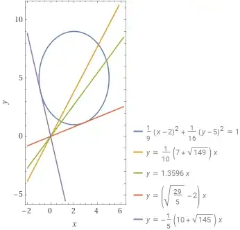

Let us consider two tangent lines $OB,OC$ where $B,C$ are tangent points on the curve $\dfrac{(x-c)^2}{a^2}+\dfrac{(y-d)^2}{b^2}=1$ with $a>0$ and $b>0$.
First, let us find the slope $M_1$ of the line $OA$.
Letting $y=mx$, we get $\dfrac{(x-c)^2}{a^2}+\dfrac{(mx-d)^2}{b^2}=1$, i.e. $$(b^2+a^2m^2)x^2-2(b^2c+a^2md)x+b^2c^2+a^2d^2-a^2b^2=0$$
Now, $D=0$ is equivalent to $$4(b^2c+a^2md)^2-4(b^2+a^2m^2)(b^2c^2+a^2d^2-a^2b^2)=0$$ i.e. $$(a^2-c^2)m^2+2cdm+b^2-d^2=0$$
If $a^2-c^2\not=0$, then letting $m_1,m_2$ be the roots, we have $$m_1+m_2=-\frac{2cd}{a^2-c^2},\qquad m_1m_2=\frac{b^2-d^2}{a^2-c^2}$$
Therefore, the equation of the line $OA$ is given by one of $$\frac{m_1x-y}{\sqrt{m_1^2+1}}=\pm\frac{m_2x-y}{\sqrt{m_2^2+1}}$$ So, $M_1$ is one of $$\begin{align}&\frac{\pm m_2\sqrt{m_1^2+1}-m_1\sqrt{m_2^2+1}}{-\sqrt{m_2^2+1}\pm\sqrt{m_1^2+1}} \\\\&=\frac{(\pm m_2\sqrt{m_1^2+1}-m_1\sqrt{m_2^2+1})(-\sqrt{m_2^2+1}\mp\sqrt{m_1^2+1})}{(-\sqrt{m_2^2+1}\pm\sqrt{m_1^2+1})(-\sqrt{m_2^2+1}\mp\sqrt{m_1^2+1})} \\\\&=\frac{\mp\sqrt{(m_1^2+1)(m_2^2+1)}-1+m_1m_2}{m_1+m_2} \\\\&=\frac{\mp\sqrt{(\frac{b^2-d^2}{a^2-c^2})^2+(-\frac{2cd}{a^2-c^2})^2-2(\frac{b^2-d^2}{a^2-c^2})+1}-1+\frac{b^2-d^2}{a^2-c^2}}{-\frac{2cd}{a^2-c^2}} \\\\&=\frac{\pm\sqrt{(a^2-b^2-c^2+d^2)^2+4c^2d^2}+a^2-c^2-b^2+d^2}{2cd}\end{align}$$ We get $$M_1=\frac{\color{red}+\sqrt{(a^2-b^2-c^2+d^2)^2+4c^2d^2}+a^2-c^2-b^2+d^2}{2cd}$$ since $M_1$ has to satisfy $(a^2-c^2)M_1^2+2cdM_1+b^2-d^2\gt 0$.)
Next, let us consider the slope $M_2$ of the line $OA_1$.
Let us use this answer. Our curve is $\dfrac{(x-c)^2}{a^2}+\dfrac{(y-d)^2}{b^2}=1$, so we get the system $\begin{cases}2x=\frac{2(x-c)\lambda}{a^2} \\2y=\frac{2(y-d)\lambda}{b^2}\end{cases}$, so eliminating $\lambda$ gives $y=\dfrac{a^2dx}{(a^2-b^2)x+b^2c}$, so we finally get
$$(a-b)^2(a+b)^2x^4-2 c (a - b) (a + b) (a^2 - 2 b^2)x^3+(-a^6+ 2 a^4 b^2 + a^4 c^2- 6 a^2 b^2 c^2+ a^2 b^2 d^2 + 6 b^4 c^2 - a^2 b^4 )x^2-2 b^2 c (a^4 - a^2 b^2 - a^2 c^2 + a^2 d^2 + 2 b^2 c^2)x+b^2 c^2 (-a^2 b^2 + a^2 d^2 + b^2 c^2)=0\tag2$$
Let $X$ be the $x$-coordinate of $A_1$. Then, $X$ is a root of $(2)$.
Then, the slope of the line $OA_1$ is given by $M_2=\dfrac{a^2d}{(a^2-b^2)X+b^2c}$.
$\angle{A_1OA}$ can be represented as $$\angle{A_1OA}=\arctan\bigg(\frac{M_1-M_2}{1+M_1M_2}\bigg)$$
Example : $a=3,b=4,c=2,d=5$
We get $M_1=\dfrac{7+\sqrt{149}}{10}$, and $(2)$ has two real roots $x\approx 0.7888, 2.6547$. The former is what we want, and so $M_2\approx 1.3596$.
So, we get $\color{red}{\angle{A_1OA}\approx 8.831^\circ}$.
mathlove
  • 139,939
  • Now the next step would be representing the error using this angle, seems like you've completed the hard part, but I'm still struggling to find how to relate this to the error between real result and the one gotten by my method. Also in the answer by Quark I suggested that this method of finding error might be flawed, because you would need to know the correct result before even finding the error. Then what would be the point of making estimates and estimations of error of those estimamtes if we already know the correct result? What are your thoughts? – bb_823 Jul 22 '23 at 09:40
