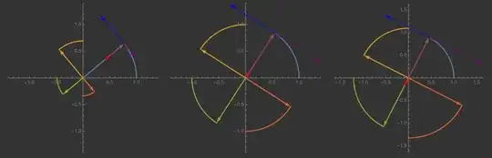

There's a lot going on in the above three pictures so let me explain them point by point.
Each graph represents a Unit Circle Parametrization in the Complex Plane with Real Numbers going horizontally and Imaginary Numbers vertically.
The first graph uses the equation $f(z) = 2^{i t}$. The second $f(z) = e^{i t}$ and the third $f(z) = 3^{i t}$.
Where $t$ runs from $[0,1]$.
For each graph the Light Blue Curve corresponds to function itself while the Yellow, Green and Orange Curves are the 1st, 2nd and 3rd Derivatives.
The correspondingly colored Vectors stemming from the Origin are the Position Vectors that "sweep out" their respective Curve.
The Light Blue Position Vector (which is the function itself, not one of its Derivatives) also has additional Vectors stemming from it which indicate its Velocity (Dark Blue), Acceleration (Red) and Jolt (Purple). Where Jolt is simply the Derivative of the Acceleration.
Notice how in all three different bases the Velocity, Acceleration and Jolt Vectors are always Perpendicular to each other.
However only the formula using Euler's Number as a Base has Derivatives that seem to "line-up" with each other.
The understand why this is and why it's important we'll have to go full on Physics mode.
