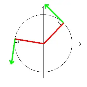

You cannot prove what the definition of $e^z$ (for complex $z$) is. However if you know what properties you want $e^z$ to have, you can possibly find a definition with those properties, and possibly prove that the definition is unique.
How do we want to define $e^z$, for $z \in \mathbb{C}$?
Here's the simplest defining property I've ever seen for it:
$$\frac {d\,e^{ix}}{dx} = ie^{ix}$$
Imagine a function $f(x)$ has the property that $f(0) = 1$ and $f'(x) = if(x)$. You might know from calculus that being given a starting point and a derivative is enough to determine a function.
Multiplying a complex number by $i$ is the same as rotating the complex number by a quarter turn: $(a + bi)i = -b + ai$, the vector$[-b,a]$ is a perpendicular counter clockwise to the vector $[a,b]$. So the relation $f'(x) = if(x)$ indicates that the movement of $f(x)$ is always perpendicular to it's location. From physics, you might know that this represents circular motion:
Circular motion
Above red vectors are $f(x)$, the location, and the green vectors are $f'(x)$. Since multiplying by $i$ doesn't change the magnitude of the vector, the speed of rotation is exactly $1$, the radius is $1$, so the frequency is $2\pi$. We can derive all of this from the above derivative property.
As other answers have indicated, you can use the series expansion instead. But for intuition I prefer the point-change approach.
