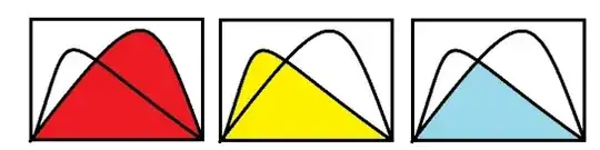

I like to think of the following pictures. The first two are $\int f_1$ and $\int f_2$ respectively, but even the smaller of these is larger than the area in the third picture, which is $\int \inf f_n$. Of course, Fatou's lemma is more subtle since we're talking about the limit infimum rather than just the minimum, but for the purpose of intuition this helps to make sure the inequalities go the right way.
  • +1 for graphical explanation. I think nothing like what you did here could illustrate Fatou's lemme. – Mikasa Nov 23 '12 at 17:41

  • In the third picture, you want to represent $\int min{f_1,f_2}$? – Groups Nov 01 '14 at 04:43
  • Nice picture, but has nothing to do with Fatou's lemma. – uniquesolution Nov 12 '15 at 14:44
  • 22
    @uniquesolution This is a special case of Fatou's Lemma, where the functions $f_n$ alternate between $f_1$ and $f_2$. (That is, $f_n=f_1$ for all odd $n$ and $f_n=f_2$ for all even $n$.) Then each "lim inf" in Fatou's Lemma reduces to a simple "inf" (or "min"). Even though it's a very special case, it suffices for the OP's objective, namely remembering which way the inequality should go. – Andreas Blass Apr 24 '16 at 00:14
