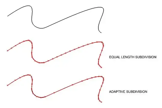

I've been researching into this for quite a while, but I seem to be getting only answers involving some programming language of which I do not have any background knowledge. Let me explain the problem:
I think "equal length subdivision" of the image should be a straightforward visualization of the problem. I have a curve (a parametric Bezier curve, to be more specific) that I want to divide such that any two consecutive points of division have equal Euclidean distances between each other. The first and the last chords have to be on the beginning and the end of the curve respectively, and all points of division should be on the curve.
Ideally I would like to have a mathematical solution (i.e. no programming) in which I can specify the number of chords to obtain the resulting division points. I am perfectly fine with calculus and ready to learn more if needed.

    My current answer assumes that you measure distance along the curve. Is this wrong? What do you mean exactly by distance of consectuive points? The usual euclidean distance? – M. Winter May 23 '17 at 10:11
  • Yes, I was referring to the usual euclidean distance, the shortest distance between two points. Sorry it seems to have been ambiguous. – CrazyRabbitKGe May 23 '17 at 10:23
    @CrazyRabbit: As M. Winter says, you need to say whether distance is measured along the curve (arc length) or in the ambient space (chord length). In either case, an analytic solution is impossible: Even if your curve is cubic Bezier, the arc length integral is not generally elementary, and cannot be expressed "in closed form", much less inverted to obtain an equal-length subdivision. On the other hand, subdividing a curve segment into equal-length chords is a global problem, arguably worse than equal-length curve segments. – Andrew D. Hwang May 23 '17 at 10:27
    I see, that seems to be the reason why almost all discussions involved program-generated algorithms. I guess I should attempt more roundabout ways of tackling it. Thanks! – CrazyRabbitKGe May 23 '17 at 10:35

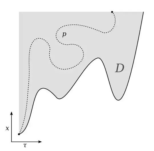

What we should see from this thought process is, that the search space for the new partition is 2-dimensional. Any cadidate is represented uniquely by a pair $(x,\tau)$. Let's define the cadidate-space
$$D:=\{(x,\tau)\in[0,1]^2\mid t_n(\tau)<x<1\}.$$
We see that the condition that $x$ is the last division point is already incorporated. $D$ might look like the gray colored area in the picture below.
$\quad\quad\quad\quad\quad\quad\quad\quad\quad\quad\quad$
Now define the following function on $D$ to have a measure for how equichordal a candidate is:
$$f(x,\tau):=\Delta(\tau) - \|c(x)-c(t_n(\tau))\|.$$
This function compares the length of the new segment to $\Delta(\tau)$. If it is zero, i.e. $f(x,\tau)=0$, then we indeed found an equichordal $(n+1)$-partition. So we are interested in the zeros of $f$. But not only this. Because we need to have a continuum of partitions parametrized by $\hat\tau$, we should actually look for a whole path of zeros inside $D$ that hopefully extends from $(0,0)$ (a partition of the empty curve) to $(1,\tau)$ (a partition of the whole curve), see the dashed black line in the image. So the last thing to do is to show that there is such a path $p:[0,1]\to D$ that is completely locate inside the zeros of $f$ and satisfies
$$ p(0)=(0,0),\quad p(1)=(1,\tau),\quad\text{for some $\tau\in[0,1]$}.$$
And here comes the big trick that will show the existence. Imagine yourself sitting on the left edge of $D$ and try to walk to the curvy edge of $D$, but without passing through a zero of $f$. First, note that
  • on the left edge all pairs have $\tau=0$, hence describe partitions of the empty curve. Therefore $\Delta(0)=0$ and hence $f(x,0)\leq 0$.
  • on the curvy edge all pairs describe the case $x=t_n(\tau)$. This means the last segment has zero length, hence $f(x,\tau)\geq 0$.
So during your journey from the left edge to the curvy one, you have to go from negative values of $f$ to positive values of $f$, and because $f$ is continuous (can be seen easily), the intermediate value theorem say that we have to pass $f=0$ at some point. Imagine the zeros as walls. Then what does it mean that we cannot reach from the one edge to the other. Probably that there is a wall (made from zeros) extending without gaps from the lowest point of $D$ to some highest point of $D$. This "wall" is our path $p$.
