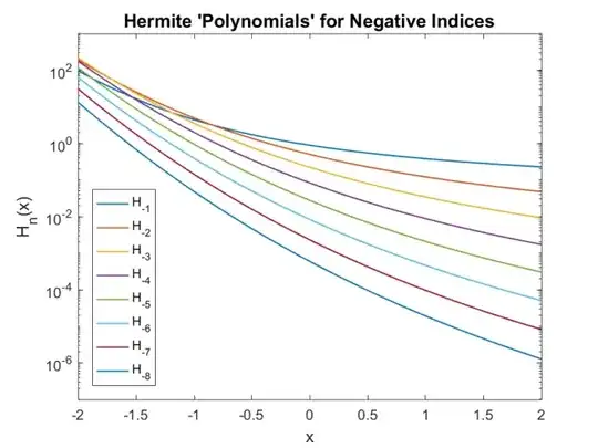

After two days of thinking about this, I see now how Hermite polynomials can be extended to negative indices from a more basic approach. I was inspired to do this because you can't argue with Claude's result. So let's return to the Rodriques formula,
$$\text{H}_n(x)=(-)^n e^{x^2} \frac{d^n}{dx^n}e^{-x^2}$$
Thinking in terms of fractional calculus, I'm going to stretch the imagination and allow for differintegration with negative $n$. Thus we boldly say that
$$\text{H}_{-1}(x)=-e^{x^2} \int e^{-x^2} dx=\frac{\sqrt{\pi}}{2} e^{x^2}\text{erfx}(x)$$
This is in agreement with Claude's result. At this point we can continue with the recursion formula since we know that $H_0=1$. Thus, working down the negative numbers,
$$\text{H}_n(x)=\frac{1}{2(n+1)}\left[2\text{H}_{n+1}(x)-\text{H}_{n+2}(x)\right],\ \ \ \ n<-1$$
Obviously, these are not polynomials, but they derive from the Hermite polynomial recursion so that's what we call it. These look much different than the regular Hermite polynomials.
The figure below show the first eight $H_n, n\le -1$. Notice the logarithmic $y$-axis. Negative Hermite Polynomials
