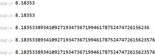

By doing numerical experiments we have found that:
\begin{equation} {\mathcal J}^{(x,b,\mu_0)}_j = \left(1 - 2 \mu_0\right)^j \tag{2} \end{equation}
In[3369]:= LL = {}; M = 2;
Do[
  {x, b} = RandomReal[{0, M}, 2, WorkingPrecision -> 50];
  If[b > x, tmp = x; x = b; b = tmp;];
  mu0 = RandomReal[{-M, 1/2}, WorkingPrecision -> 50];
  j = RandomReal[{-M, M}, WorkingPrecision -> 50];
  ll = {1/Sqrt[Pi] NIntegrate[
      2^(j/2 - 1) (t)^(-j/2 - 1)
        Exp[-((Log[b/x] - (mu0 - 1/2) t)^2/( 2 t))] HermiteH[j + 1,
        Log[x/b]/(Sqrt[2] t^(1/2))], {t, 0, Infinity},
      WorkingPrecision -> 20], (1 - 2 mu0)^j};
  LL = Join[LL, {ll}];
  , {which, 1, 100}];
Mean[Abs[#[[1]]/#[[2]] - 1] & /@ LL]
Out[3371]= 2.425121*10^-13

1/Sqrt[Pi] NIntegrate[ 2^(j/2 - 1) (t)^(-j/2 - 1) Exp[-((Log[b/x] - (mu0 - 1/2) t)^2/( 2 t))] HermiteH[j + 1, Log[x/b]/(Sqrt[2] t^(1/2))], {t, 0, Infinity}]
1/Sqrt[Pi] Exp[+(-(1/2) + mu0) Log[b/ x]] Sum[(j + 1)!/((j + 1 - 2 m2)! m2!) 2^(j - 1/2 - m2) (-1)^(-m2) ( Log[x/b])^(j + 1 - 2 m2) NIntegrate[ t^(-(3/2) - j + m2) Exp[-(1/8) (1 - 2 mu0)^2 t - Log[b/x]^2/(2 t)], {t, 0, Infinity}], {m2, 0, Floor[(j + 1)/2]}]
(Use https://math.stackexchange.com/questions/128687/bessel-function-
integral-and-mellin-transform?rq=1 (Gradshteyn&Ryzhik 3.471.9,) at
alpha =Log[b/x]^2/2, beta = 1/8 (1-2 mu0)^2, nu = -1/2-j+m2
) 1/Sqrt[Pi] Exp[+(-(1/2) + mu0) Log[b/ x]] Sum[(j + 1)!/((j + 1 - 2 m2)! m2!) (-1)^(-m2) ( Log[x/b])^(1 - m2 - 1/2) (1/(1 - 2 mu0))^((-1/2 - j + m2)) BesselK[-1/2 - j + m2, Log[x/b] (1/2 - mu0)], {m2, 0, Floor[(j + 1)/2]}] (Use https://functions.wolfram.com/Bessel-TypeFunctions/BesselK/03/
01/02/02/0001/
) (1 - 2 mu0)^j If[j == -1, 1, Sum[(j + 1)!/(-L + j)! Sum[((-1)^(-m2) (+L + j - 2 m2)! )/((j + 1 - 2 m2)! m2! (L - m2)! ), {m2, 0, Min[Floor[(j + 1)/2], L]}] (Log[x/b] (1 - 2 mu0))^(-L) , {L, 0, j}]]
((1 - 2 mu0)^j)
