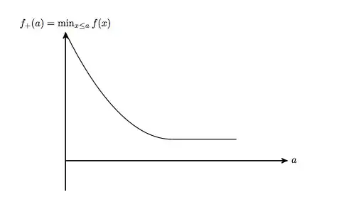

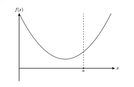

Consider the problem $$ \begin{aligned} \mbox{min} \quad& f(x) \\ \mbox{subject to} \quad& x\le a\\ \end{aligned} $$ illustrated below and where $f$ is convex: enter image description here
The essential features are there in this problem despite it being the most basic problem with an inequality. Now consider the optimum given as a function of $a$. So $f_+(a)=\inf_{x\le a}f(a)$. Its graph looks like this:
It's basically like the original $f$ except that we only have the descending parts and none of the ascending parts.

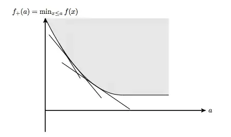

We're going to construct $f_+$ by a slightly roundabout way, not by considering the function itself, but its epigraph, the set of points above the graph. Here's the epigraph for the original $f$:
Notice I've drawn a bunch of lines just touching the epigraph, ie. its subtangents. In general, any convex shape can be expressed as the intersection of half-planes. Those subtangents indicate a handful of the boundaries of those half planes. We can construct those subtangents by considering the lines $y=\lambda x$ and then pushing those lines up or down so each is high as possible without crossing $f$. We can find out how much pushing we need by solving the optimisation: $$ \begin{aligned} \mbox{maximise} \quad& \lambda x-f(x) \end{aligned} $$ and we call the optimal value $f^\ast(\lambda)$. $f^\ast$ is also known as the Legendre transform or Fenchel dual. It's basically telling us which half-planes define our epigraph. Interestingly, reconstructing the function $f$ from $f^\ast$ requires exactly the same expression. So the Fenchel dual also takes a collection of half-planes and gives you back the original function.
So now we want to construct the epigraph of $f_+$. We just want the descending parts of $f$. It's easy to construct the epigraph, we take the intersection of just the half-planes whose boundaries are decreasing. Here's a picture:
So here's a process for constructing $f_+$: we take the Fenchel dual of $f$, we throw away the "half" where $\lambda\ge0$, and now take the inverse Fenchel dual (which is in fact just the Fenchel dual).
Now let's construct the dual to our original optimisation problem as described in numerous textbooks. We form the Lagrangian $$L(a,x,\lambda)=f(x)+\lambda (x-a)$$ We then form the function $$g(a,\lambda)=\min_x L(a,x,\lambda)$$ This is basically (modulo a sign) the Fenchel dual of $f$ with an extra $-\lambda a$ term.
The dual problem, as in the textbooks, is $$ \begin{aligned} \mbox{maximise} \quad& g(a,\lambda)\\ \mbox{such that} \quad & \lambda\ge0\\ \end{aligned} $$ Remembering that $-\lambda a$ term, that's almost the inverse Fenchel dual except we've maximised over just "half" of the $\lambda$s, those for which $\lambda\ge0$. When we compute the optimum of the dual problem we get $h(x)=\max_x g(a,x)$. If the problem is convex, we've just computed $f_+$ by another path.
So this gives what I think is a clear picture of what the dual problem is. Forming the dual problem is (modulo a vertical shift) converting the original problem into finding the subtangents. Solving the dual problem is converting that back to a function again, but using only the downward sloping lines.
