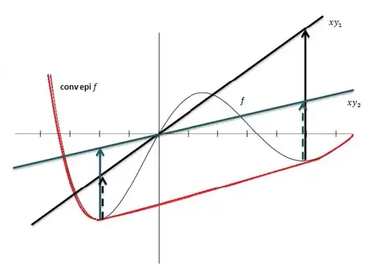

Suppose $f: \mathbb{R}^n \to \mathbb{R}$, then the conjugate function is: $$f^*(\mathbf{y}) \triangleq \sup_{x\in \text{dom} f} [\mathbf{y}^ \mathsf{T}\mathbf{x}-f(\mathbf{x})],$$ where: $\text{dom}f^* = \{\textbf{y}|f^*(\mathbf{y})<+\infty\}$. Then, it is clear from the definition that it is a function bounded above.
Some notions and descriptions about the conjugate function:
  1. Even if $f(x)$ is a non-convex function, then the conjugate function $f^*(\mathbf{y})$ is guaranteed to be a convex function in $\mathbf{y}$. [Notice: The conjugate function is the pointwise supremum of a set of affine functions in $\mathbf{y}$ (here, convexity aspect of affine function matters) , so, it is convex.]
  2. As an interpretation, it somehow represents (encodes) the convex hull of the epigraph of $f$ in terms of its supporting hyperplanes (The concept behind this is depicted in figure below.).enter image description here
