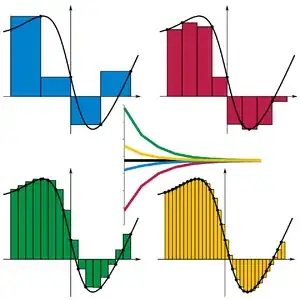

The motivation behind integration is to find the area under a curve. You do this, schematically, by breaking up the interval $[a, b]$ into little regions of width $\Delta x$ and adding up the areas of the resulting rectangles. Here's an illustration from Wikipedia:
Riemann sum illustration
Then we want to make an identification along the lines of
$$\sum_x f(x)\Delta x\approx\int_a^b f(x)\,dx,$$
where we take those rectangle widths to be vanishingly small and refer to them as $dx$.
