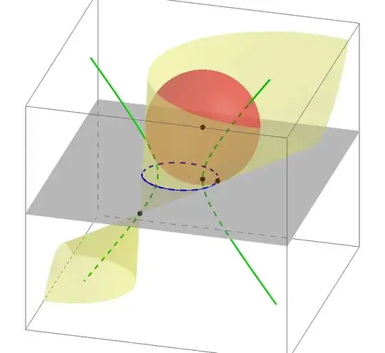

There's so-called thread construction, please see p.19 of this onwards.
Note that the two focal conics are called conjugate conics and their eccentricities are reciprocal to each other.
Any point on the conjugate conics is the radiant point of the enveloping cone for that conic and of its Dandelin sphere.
