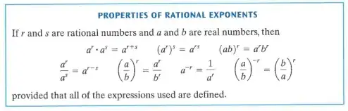

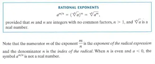

Ratti's definition of rational exponents Ratti's properties of rational exponents
The thing that looks the most suspect in my example above is the 4th equality, $(-1)^{2 \cdot \frac{1}{2}} = ((-1)^2)^\frac{1}{2}$, which seems to violate the spirit of Ratti's definition of rational exponents ("no common factors")... but technically, that translation from rational exponent to radical expression was not used at this point. Rather, we're still only manipulating rational exponents, which seems fully compliant with Ratti's 2nd property: $(a^r)^s = a^{rs}$, where indeed "all of the expressions used are defined". The rational-exponent-to-radical-expression switch (via the rational exponent definition) doesn't actually happen until the 6th equality, $(1)^\frac{1}{2} = \sqrt{1}$, and that seems to undeniably be a true statement. So I'm a bit stumped at exactly where the falsehood lies.
We can find effectively identical definitions in other books. For example, in Sullivan's College Algebra, his definition is (sec. R.8): "If $a$ is a real number and $m$ and $n$ are integers containing no common factors, with $n \ge 2$, then: $a^\frac{m}{n} = \sqrt[n]{a^m} = (\sqrt[n]{a})^m$, provided that $\sqrt[n]{a}$ exists"; and he briefly states that "the Laws of Exponents hold for rational exponents", but all examples are restricted to positive variables only. OpenStax College Algebra does the same (sec. 1.3): "In these cases, the exponent must be a fraction in lowest terms... All of the properties of exponents that we learned for integer exponents also hold for rational exponents."
So what exactly are the restrictions on the Laws of Exponents in the real-number context, with rational exponents? As one example, is there a reason missing from the texts above why $(-1)^{2 \cdot \frac{1}{2}} = ((-1)^2)^\frac{1}{2}$ is a false statement, or is it one of the other equalities that fails?

    Rational exponents are not defined for negative real numbers. So, the paradoxa you describe do not exist. – Björn Friedrich Jan 27 '16 at 06:21
  • @BjörnFriedrich: No, the example that immediately follows Ratti's definition is: $(-8)^\frac{2}{6} = (-8)^\frac{1}{3} = \sqrt[3]{-8} = -2$. – Daniel R. Collins Jan 27 '16 at 06:26
    Your objection to his example is wrong, because he did not say what $a^\frac{m}{n}$ is when $\gcd(m,n) \ne 1$. He only specified what it is when $\gcd(m,n) = 1$, implying that to find the value in general you must first convert it to a form where the rational exponent is expressed in lowest terms. However, as my answer says, his example is wrong for a different reason, namely that his rules are inconsistent due to your example, and that the consistent versions are not enough to specify it but we further need additional definition for $n$-th roots where $n$ is odd. – user21820 Jan 30 '16 at 03:13
  • @user21820: "he did not say what $a^\frac{m}{n} $ is when $gcd(m,n)≠1$". Indeed; making it an undefined expression; I disagree that your implication is necessarily inferred. – Daniel R. Collins Jan 30 '16 at 03:15

You have put your finger precisely on the statement that is incorrect.
There are two competing conventions with regard to rational exponents.
The first convention is to define the symbol $a^x$ for $a > 0$ only. The symbol $\sqrt[n]{a}$ is defined for negative values of $a$ so long as $n$ is odd, but according to this convention, one wouldn't write $a^{1/n}$, for instance.
In defining $a^{p/q}$ to be $(\sqrt[q]{a})^p$, the author you quoted chose the fraction $p/q$ to be in lowest form so that the definition would be unambiguous. For example, $a^{10/15}$ is defined to be $(\sqrt[3]{a})^2$. However, it is preferable to define $a^{p/q}$ to be $(\sqrt[q]{a})^p$ in all cases and to prove that this definition is independent of the particular representation chosen for $p/q$; this is what more rigorous books tend to do. That is, you prove that if $p/q = r/s$, then $(\sqrt[q]{a})^p = (\sqrt[s]{a})^r$. There is no mention of lowest form.
The competing convention is to also allow $a^x$ to be defined for all $a \ne 0$ and all rational numbers $x = p/q$ that have at least one representation with an odd denominator. You then prove that $(\sqrt[q]{a})^p$ is independent of the particular representation $p/q$ chosen, so long as the denominator is odd. Thus you can write $a^{3/5} = (\sqrt[5]{a})^3 = (\sqrt[15]{a})^{9} = a^{9/15}$. All of that is fine. However, you cannot write $a^{6/10} = (\sqrt[10]{a})^6$, or even $a^{6/10} = \sqrt[10]{a^6}$. The number $a^{6/10}$ is well-defined, but to write down its definition, you must first select a fraction equivalent to $6/10$ that has an odd denominator, which could be $3/5$ or $9/15$ or something else. For $a^{1/2}$, this can't be done at all, so $a^{1/2}$ is undefined for $a < 0$.
The rules for exponents break down if you start allowing $a < 0$ and exponents that can't be written with an odd denominator. For example, the rule $a^{xy} = (a^x)^y$ is valid, but only so long as $x$ and $y$ are both rational numbers that can be written with an odd denominator. This is not the case if you write $a^1 = (a^2)^{1/2}$, despite the fact that both sides of the equation are defined since $a^2 > 0$.

The 4th equality is indeed suspect, but not for the reason you suggest. It is an application the 2nd property of rational exponents that you list above:
If $r$ and $s$ are rational numbers and $a$ is a real number, then we have: $$(a^r)^s = a^{r\cdot s}$$
provided that all expressions used are defined.
More formally and less ambiguous would be:
$$\forall r,s \in \mathbb{Q}\colon \forall a \in \mathbb{R}\colon [a^r\in \mathbb{R} \land a^s\in \mathbb{R} \implies (a^r)^s=a^{r\cdot s}]$$
This statement makes it clear that we cannot infer $((-1)^2)^\frac{1}{2}=(-1)^{2 \times \frac{1}{2}}$ as in the "paradox" because $(-1)^\frac{1}{2} \notin \mathbb R$, i.e. because $(-1)^\frac{1}{2}$ is not defined.
That both restrictions are necessary can be seen from the fact that we must have $a^{r\cdot s}=a^{s\cdot r}=(a^s)^r=(a^r)^s$. If we had $a^s \notin \mathbb{R}$, we could not make this substitution.
With this in mind, we could restate the rule as follows:
$$\forall r,s \in \mathbb{Q}\colon \forall a \in \mathbb{R}\colon [a^r\in \mathbb{R} \land a^s\in \mathbb{R} \implies a^{r\cdot s}=(a^r)^s=(a^s)^r]$$

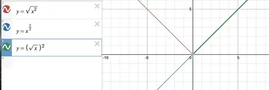

The issue is that $a^{\frac{1}{n}}$ is multivalued. You could arguably simplify the first calculation into $1 = \sqrt{1} = -1$. Taking different branch cuts is how the "paradox" arises.
Essentially, in the context of the reals (or even the complex numbers) $\sqrt{a}$ is one name for two functions, say $\sqrt[+]{a^2} = a$ and $\sqrt[-]{a^2} = -a$. All the laws are fine as long as you remain consistent with your choice. (Alternatively, by moving to a Riemann surface you don't have to make and track a choice... well, you have to decide when and how you are going to embed your reals into the Riemann surface, but once you do, no more choices.)
Whenever square roots entered the picture — you can say at $-1 = (-1)^{\frac{2}{2}}$ or at $((-1)^2)^{\frac{1}{2}}$ — it explicitly chose, going from left-to-right, the non-standard choice of $a^{\frac{1}{2}} = \sqrt[-]{a}$. If it chose the standard choice which it uses later on then, $-1 = -(-1)^{\frac{2}{2}} = -((-1)^2)^{\frac{1}{2}}$ and everything would work out. If it was consistent with the choice of $\sqrt[-]{}$ then $\sqrt{1} = \sqrt[-]{1} = -1$ would also have led to a correct result.
Moving my comment to the answer, a crucial source of confusion is that the definition of $a^{\frac{m}{n}}$ is not a well-defined function of the rationals in that it doesn't respect equality of the rationals. This is witnessed by the need for $\frac{m}{n}$ to be in lowest terms, and, relevant here, the fact that $1 = \frac{n}{n}$ does not imply $a^1 = a^{\frac{n}{n}}$. In fact, the ill-definedness of the provided definition of $a^\frac{m}{n}$ is entirely reduced to the question of what $a^\frac{n}{n}$ is.
So to put it in terms of rules: all the rules are valid, what's invalid is cancelling common factors in a "rational" exponent because the exponents aren't actually rational numbers.
    Downvoted because this is inconsistent with the real definitions in use here. Ratti sec. P.6: "Definition of Principal Square Root: $\sqrt{a} = b$ means (1) $b^2 = a$ and (2) $b \ge 0$". Perhaps you could improve your answer this way: Granted that $a^\frac{1}{n}$ is definitely not multivalued under this real definition, what additional verbiage is required in the properties of exponents to prevent this falsehood? – Daniel R. Collins Jan 27 '16 at 06:18
  • The key, based on the images you included, is that $a^{\frac{2}{2}}$ hasn't been defined since 2 definitely shares a common factor with 2. So the "failure" is that $a = a^{\frac{n}{n}}$ is not true in general. In particular, whenever you reduce a rational exponent to radicals, if the fraction isn't in lowest terms, you will end up with an expression like $a^{\frac{n}{n}}$ for some $a$. – Derek Elkins left SE Jan 27 '16 at 06:29

No continuous definition of $a^r$ can be made for all real $a$ and $r$; and likewise, the familiar properties of exponents cannot be extended consistently to all real bases and powers. As a result, there are a number of competing definitions for $a^r$ for non-integer values $r$, depending on how much the author wishes to extend these properties, and in what direction. Here are some things that we can positively say for an identity like $(a^r)^s = a^{rs}$:
  • It is true for all natural numbers $r$ and $s$, and all real numbers $a$. [1]
  • It is true for all integers $r$ and $s$, and all nonzero reals $a$.
  • It is true for all real $r$ and $s$, and all positive reals $a$.
Note that the more permissive we are with $r$ and $s$, the more restrictions we must place on $a$. Some authors do further extend the real-valued definition of $a^r$ (and hence related properties) to negative real $a$'s and non-integer rationals $r$ (while others do not); but this is a fairly fragile definition, in that to be well-defined it requires that $r = m/n$ be written with an odd value for $n$ (books in this vein usually specify that it be in lowest terms). Among the greatest problems with such an approach is that a real-valued “principal $n$th root” will give contradictory results to the complex-valued “principal $n$th root” for negative bases. For example, if a real-valued definition is given, then $(-8)^{1/3} = -2$; but by the standard complex-valued definition, $(-8)^{1/3} = 1 + \sqrt{3}i$. This seems to create some confusion when discussing the issue across different contexts. Arguably it would be best to refrain from that very limited extension in reals, so as to not conflict with the more general complex-valued definition. (See the cited articles in the question above for some published debates on the wisdom of using such a real-valued definition for negative bases and non-integer exponents.)
Regarding the example in the question, most everyone agrees that $(-1)^{2 \cdot \frac{1}{2}} \ne ((-1)^2)^\frac{1}{2}$, if both sides are simplified in the standard order of operations; and this highlights the fact that the identity $(a^r)^s$ = $a^{rs}$ is not true unrestrictedly. Exactly what restrictions need to be honored depend on the definitions in use in a particular textbook. For Ratti, we might rescue the presentation by interpreting the clause “provided that all of the expressions used are defined” in the broad sense of every expression inside the box (not just the one identity being used), and since $a^s$ appears in other places in the box, and $(-1)^\frac{1}{2}$ is certainly undefined in real numbers, then the assertion $((-1)^2)^\frac{1}{2} = (-1)^{2 \cdot \frac{1}{2}}$ (the 4th equality) would thereby be proscribed.
[1]: And more generally for $a$ an element of any ring.
$(a^r)^s=a^{rs}$ can indeed be false for $a<0$, as shown by your example.
You can "rescue" this rule by stating instead "$(a^r)^s=a^{rs}=(a^s)^r$, provided all three expressions are defined". (As the product is commutative, you cannot really distinguish $r$ and $s$.)
    While the "rescue" would be technically correct, stating it thus would be a pedagogical disaster. Saying three expressions are all equal provided "all of the expressions used are defined" is just inviting the error of assuming any two of them are equal provided they are defined. If you need to compare those two expressions, you don't really need to use the third expression at all, so it is not even obvious that "all of the expressions used are defined" is being violated. – Marc van Leeuwen Feb 04 '16 at 05:23

Edit: I'm now disavowing this answer, but keeping it here to maintain the comments. Consider my newer answer elsewhere for, I think, a better treatment.
I would currently argue that it's the 2nd equality in the example, $(-1)^1 = (-1)^\frac{2}{2}$, that contains the initial error. It's illegitimate to write $(-1)^\frac{2}{2}$ because that's an undefined expression, although the exact reason depends on which of two common definitions of $a^\frac{m}{n}$ is in use in a given textbook:
  • Some books at the college-algebra level define rational exponents for any real number $a$, but only for rational exponents written in lowest terms (i.e., $m$ and $n$ with no common factors). In this case, $(-1)^\frac{2}{2}$ in invalid because of the common factor in the exponent.
  • Other books, including those at the real analysis level, define rational exponents only for nonnegative real $a$ (i.e., $a \ge 0$), but permit any $m$ and $n$ regardless of common factors. In this case, $(-1)^\frac{2}{2}$ is undefined because of the negative base.
In summary: for $a > 0$, any $(-a)^\frac{n}{n}$ is a meaningless piece of writing. The way that this expression violates the definition of a rational exponent depends on the exact definition in use.
  • I would say instead that the statement you quoted should be corrected by restricting it to cases in which $n$ is even and has no common factors with $m$. – David Jan 27 '16 at 08:26
  • @David: I see why you say that; I spent in inordinate amount of time trying to figure out whether that was implicit in the statement or not. But even if it was, then the expression $(-8)^\frac{2}{6}$ seems to violate the given definition in the first place with its common factors. – Daniel R. Collins Jan 27 '16 at 16:20
  • Edited this answer to make it more concise and cover both oft-seen definitions. I would still argue here that Ratti should delete the example that shows $(-8)^\frac{2}{6} = (-8)^\frac{1}{3} = \sqrt[3]{-8} = -2$. Thanks to David and DerekElkins for helpful answers/comments. – Daniel R. Collins Jan 27 '16 at 16:47

Graphically the results look very different. Reinforcing the differences.
