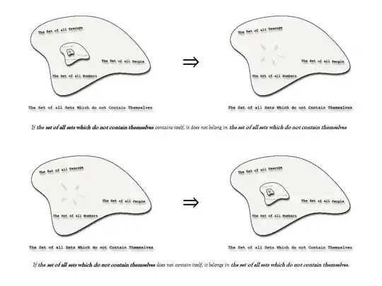

Perhaps the following image will help take from here:

An informal explanation is Russel's Paradox. The wiki page is informative, here's the relevant quote:
Let us call a set "abnormal" if it is a member of itself, and "normal" otherwise. For example, take the set of all squares. That set is not itself a square, and therefore is not a member of the set of all squares. So it is "normal". On the other hand, if we take the complementary set that contains all non-squares, that set is itself not a square and so should be one of its own members. It is "abnormal".
Now we consider the set of all normal sets, R. Attempting to determine whether R is normal or abnormal is impossible: If R were a normal set, it would be contained in the set of normal sets (itself), and therefore be abnormal; and if it were abnormal, it would not be contained in the set of normal sets (itself), and therefore be normal. This leads to the conclusion that R is both normal and abnormal: Russell's paradox.
