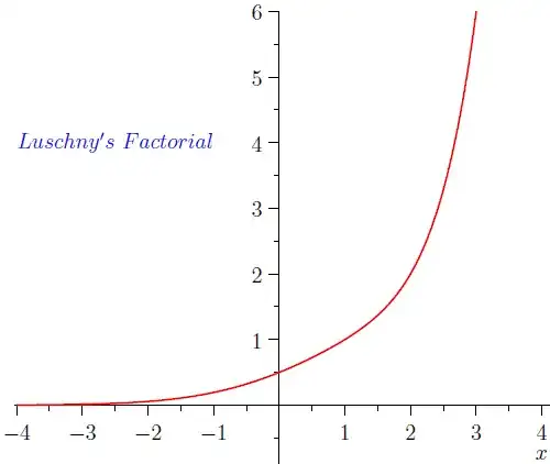

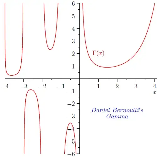

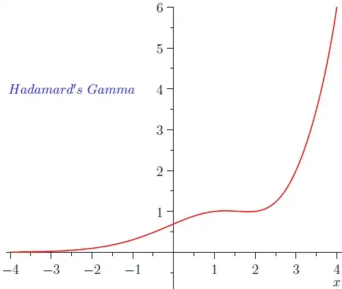

Actually there are other (less-frequently) used extensions to the factorial, with different properties from the gamma function which may be desirable in some contexts.
Euler's Gamma Function
Hadamard's Gamma function
Luschny's factorial function
See here for more information.
