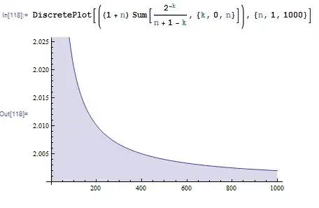

For large $n$ the sum approaches the value of $2$ from above:
I am hoping this sum has a nice probabilistic underpinnings to it.
