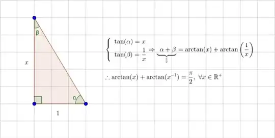

Right triangle with legs $1$ and $x$, just remembering the sum of all the angles of a triangle, is $\pi$. In case of a right triangle, $\alpha+\beta={\pi\over2}$ for any $x$.

Here's a proof in the case when $x > 0$.
Draw a right triangle with legs $1$ and $x$, with the leg of length $x$ opposite angle $A$.
Then $\tan(A) = x$ and $\tan(B) = 1/x$, so $A = \arctan(x)$ and $B = \arctan(1/x)$.
Since $A+B = \pi/2$, $\arctan(x)+\arctan(1/x) = \pi/2 $.
