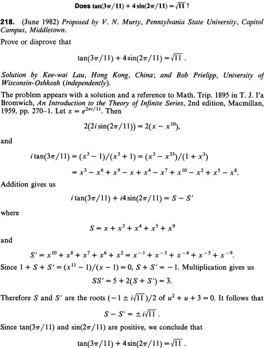

A proof, which I got from just googling, appears as a solution Problem 218 in the College Mathematics Journal.
Snapshot:
alt text
