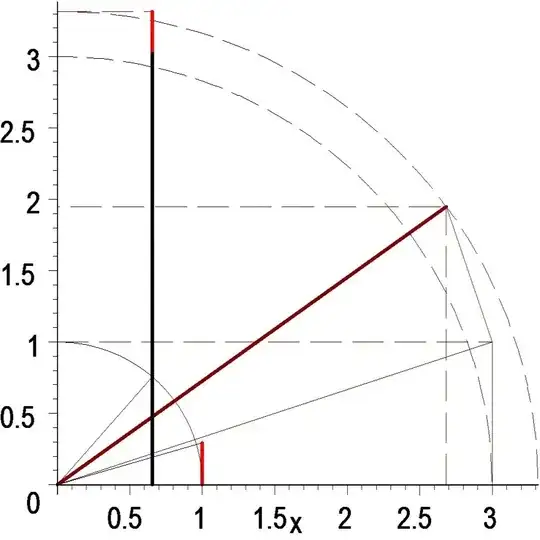

I could only think of a direct trigonometric interpretation of the identity.
The radius of the circular sector is 1. The measures of the central angles and the lengths of the line segments are:
  1. The smaller angle: $\pi/11$ rad.
  2. The bigger angle: $3\pi/11$ rad.
  3. The red line segment: $\sqrt{11}$.
  4. The vertical black line segment: $4\sin(3\pi/11)$.
  5. The vertical light red segment: $\tan(3\pi/11)$.
The red line segment is the hypotenuse of the right triangle whose catheti are the line segment with length $\sqrt{10}$ and the orthogonal unit segment. The $\sqrt{10}$ line segment is the hypotenuse of the right triangle whose catheti are the horizontal line segment with length 3 and the vertical line segment with length 1.
Edited: The angle $\pi/11=2\pi/22$ is not constructible with compass and straightedge (Wikipedia, Constructible polygon ). Therefore the figure is an impossible construction with compass and straightedge only.
