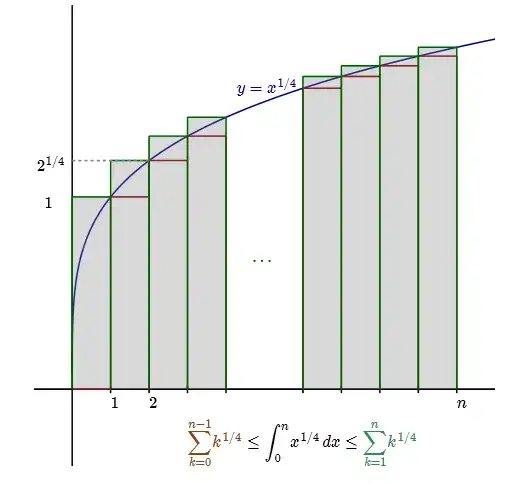

Let $k\geqslant1$. Since the function $x\mapsto x^{1/4}$ is increasing, $(k-1)^{1/4}\leqslant x^{1/4}\leqslant k^{1/4}$ for every $k-1\leqslant x\leqslant k$. Integrating this double inequality yields $$ (k-1)^{1/4}\leqslant\int_{k-1}^kx^{1/4}\mathrm dx\leqslant k^{1/4}. $$ Summing these from $k=1$ to $k=n$ yields $$ s_{n-1}=\sum_{k=0}^{n-1}k^{1/4}\leqslant\int_{0}^nx^{1/4}\mathrm dx\leqslant \sum_{k=1}^{n}k^{1/4}=s_n. $$ Since the integral is $\tfrac45n^{5/4}$ and $s_{n-1}=s_n-n^{1/4}$, this yields, for every $n\geqslant1$, $$ \tfrac45n^{5/4}\leqslant s_n\leqslant\tfrac45n^{5/4}+n^{1/4}. $$ Note finally that $n^{1/4}=o(n^{5/4})$ hence a (much weakened) version of this is $s_n\sim\tfrac45n^{5/4}$.

Here is a diagram to accompany Did's fine answer:
