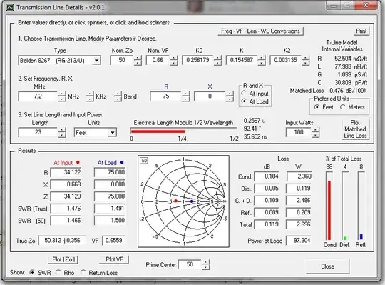

Transmitter Output Efficiency
The final efficiency factor to be considered is the output power of the transmitter. Most amateur transmitters are designed to deliver their rated output power when connected to a 50 ohm resistive load. Any deviation from this load will typically result in lower output power from the transmitter. This loss of transmitter output power effectively reduces the efficiency of the system.
For example, a 100 watt, 50 ohm source impedance transmitter that is connected to the 23 feet of RG213 that is terminated with our 75 ohm dipole, will output 96 watts (if no protection circuits kick in). This is an output efficiency of 96% (a 0.17 dB loss). Note that this is most likely more efficient, in this example, than using an antenna tuner at the transmitter to match the transmitter impedance to the feedline impedance (even though this is a 1.5:1 SWR).

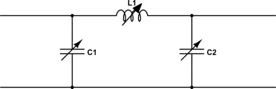

What is an antenna tuner?
It's any network of components designed to match one impedance to another, with variable components to accommodate use at a number of frequencies or with a variety of antennas. Frequently, it's a PI network:
schematic
simulate this circuit – Schematic created using CircuitLab
