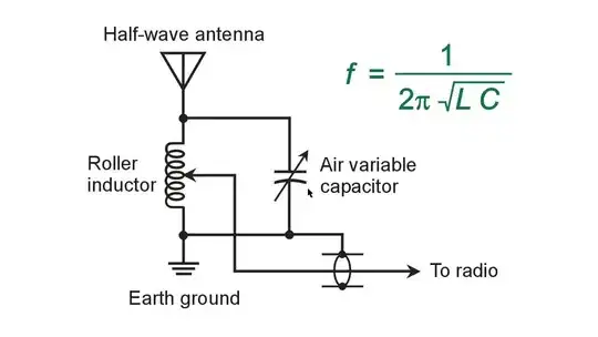

The first is presented, among others, in a nice video by Stan Gibilisco but applies to wire antennas, whereas I would like to have a loop or dipole antenna.
second

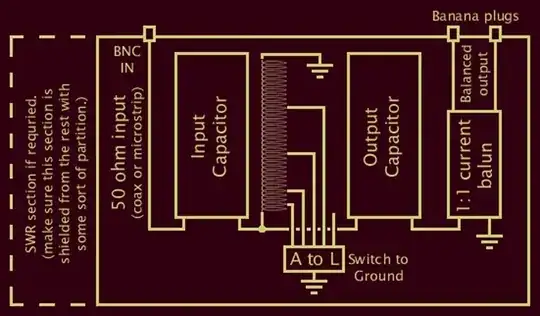

The second is presented here although is designed for transmission and not reception.
As far as my understanding goes, the one from Gibilisco is essentially a tank circuit defined by L and C that can be tuned to a specific resonant frequency and the inductor is used for impedance matching with the radio.
The other is a series LC circuit (T-network) but I don't understand why a second capacitor is needed. There is a sort of explanation on the link but I can't wrap my head around it.

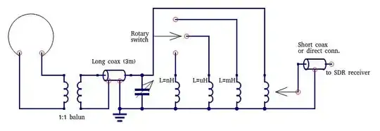

Furthermore I would like feedback on what I'm thinking of building:
antenna tuner
The loop (about 1m diameter) is placed outside and is directly connected to a 1:1 current balun (ferrite ring) that feeds to a coax cable going inside. The variable capacitor (50-1000pF, two gang connected together) is in parallel with a rotary switch that can insert different inductors to have different tank circuits for different bands. A variable inductor is in parallel with the tank circuit and gives the impedance matching for the radio (since I don't have one or I will need to buy one this will be inserted later in the circuit).
  1. Is it a sensible design?
  2. If 1., is the value of the last inductor (the "matching" inductor) relevant?
  3. Is the balun going to change its transformer ratio (that right now is 1:1) when different inductors are switched in the circuit?
4. Related to the second design (the VK5AJL design), why there are two capacitors? Wouldn't a L or tank circuit also work?

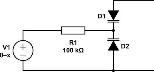

http://www.radio-electronics.com/info/data/semicond/varactor-varicap-diodes/circuits.php has a few very minimal circuits illustrating the usage of varicaps. The back-to-back configuration is what you usually encounter:
schematic
simulate this circuit – Schematic created using CircuitLab

L scales with size and length of the coil, and C is usually made adjustable. Thus, in the place where in the classical small-loop antenna you'd find the manually adjustable capacitor, you could place the adjustable capacity circuit I mentioned above. Battery operation is a good idea here, for both noise and potential separation reasons; that doesn't mean you couldn't also use a bog-normal 230 V -> 12 V transformer, rectify the resulting voltage, smoothen the hell out of that voltage and then add a simple voltage divider or adjustable voltage regulator to drive the varicaps, as long as everything float relative to your receiver – you'll be the ground of your voltage source to one end of your receiver coil, and you don't want that to be "accidentally" connected to real ground.
Regarding practical varicaps that you can buy:
well, look in the places where you'd buy electronic components. I've got good experiences with Mouser, shipping was 5–6€, I think. The BB 640 series (datasheet) looks like a good match for you – nearly 20 times the maximum capacity than minimum capacity means that you can change the resonant frequency over a range of $\sqrt{20}$ (see above formula for resonant frequency). If the maximum achievable capacity is too low for you, just put multiple in parallel.

For your loop antenna concept - no, it is not a sensible design but some slight tweaks will bring substantial improvement.
A balun is not a universal impedance transformation or choking device. When it is presented with largely reactive loads, its characteristics differ from ideal. This often results in core losses and in worst cases, destruction of the balun in a transmitting configuration.
A small loop antenna exhibits very high inductive reactance and very low radiation resistance. The variable capacitor is normally placed on the loop side of the diagram in order to be most effective in countering the inductive reactance.
The tuning will be quite sharp so you may wish to design a remote tuning feature for the variable cap.
There are several loop modeling tools on the Internet. Once you have modeled the antenna to determine its complex impedance, then the balun and antenna tuner can be configured to match. Doing it prior to modeling is just taking a shot in the dark.
