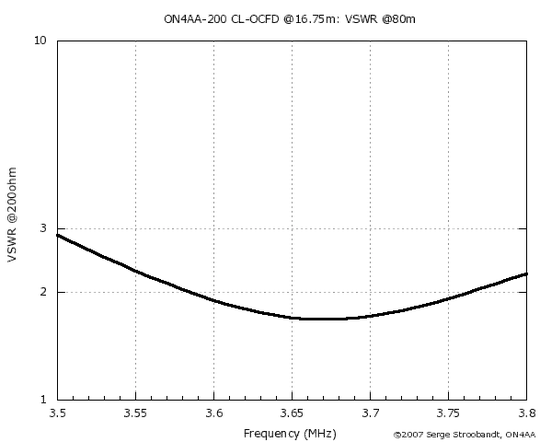

For example, here is a graph of the 80m VSWR bandwidth of my multiband CL-OCFD.
ON4AA CL-OCFD 80m VSWR bandwidth
