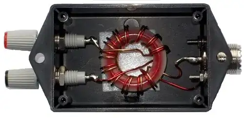

Design 3: Parallel wires wrapped around a core (see picture below)
This is the one that doesn't make sense to me. The windings would block common-mode currents, sure. So I suppose your antenna would be fed a balanced signal. But the coax ends before the windings. Wouldn't that mean RF can still flow to the outside of the shield?
a howebrew balun
(From http://www.m0pzt.com/baluns/)

I'll explain the operation of that balun very briefly: for the differential mode (which by definition has equal but opposite currents on each conductor), each conductor induces an equal but opposite magnetic flux in the core. These magnetic fluxes cancel, and so the differential mode sees no inductance: it's as if the core and the windings aren't there.
Meanwhile the common mode interacts with the core like an ordinary, single wire, and sees a large inductance. This high inductance makes the common mode on the coax a high impedance (hopefully) relative to a lower impedance path like radials, the other arm of a dipole, or some other deliberate counterpoise.
But I think your question isn't really about how it works. Rather, it's a mental hangup right here:
With coax in particular, due to skin effect, the inside and outside of the shield act as different conductors.
So, I bet you are thinking that with the balun pictured in your question, the end of the coax is "exposed", and that means common mode current can "get in", causing problems. You may be thinking once the common-mode current is inside it's stuck there, isolated from the outside by skin effect. With coiled coax or coax through beads the integrity of the coax is maintained, so nothing can "get in".

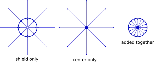

Let's consider a cross-section of coax with equal but opposite charges on the center and shield, and the associated electric fields:
Added together, there's no field at points outside the shield. That the charges are on the inside of the shield is really not the primary thing to be thinking about, because if the charges on the inner conductor went away, the charges on the shield would migrate to the outside.
And so getting back to your question about the balun, you don't need to be concerned so much with the distinction between the inside and the outside of the shield. Rather, think about maintaining equal and opposite currents and charges on the shield and center. If you do that, the fields will cancel like this, and the coax won't radiate.

  • You're almost spot on about the mental hangup. It wasn't so much that I was thinking common mode current could get "stuck inside" so much as the outside of the shield provides a path for current to "leak away" from the rest of the system, and radiate. Either way, this clears that misconception up. – Dominick Pastore Dec 28 '16 at 18:12
    Glad you found it useful @Dominick. Another key point I should have included: the physical size of the balun is very small compared to wavelength, and this is why we can consider it a lumped element. If the balun were much larger, or the wavelength much smaller the picture would be very different, and we'd need to consider not only how the balun can work (it wouldn't), but also radiation from the wires inside the balun box, etc. – Phil Frost - W8II Dec 28 '16 at 18:45
  • Speaking of physical dimensions, I had another question. Wrapping twin-lead around a toroid would be one thing, but when it's just a pair of wires as in the original picture, there's certainly no precise spacing between the conductors. Does that have any negative effects? (This might be better asked as a separate question.) – Dominick Pastore Dec 28 '16 at 19:20
  • @Dominick yes, separate question please. – Phil Frost - W8II Dec 28 '16 at 20:53
